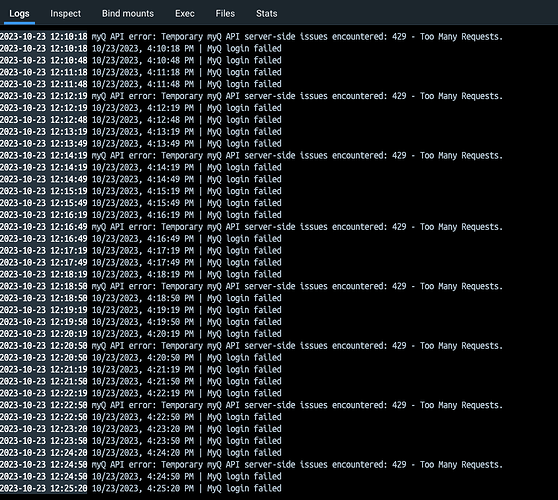

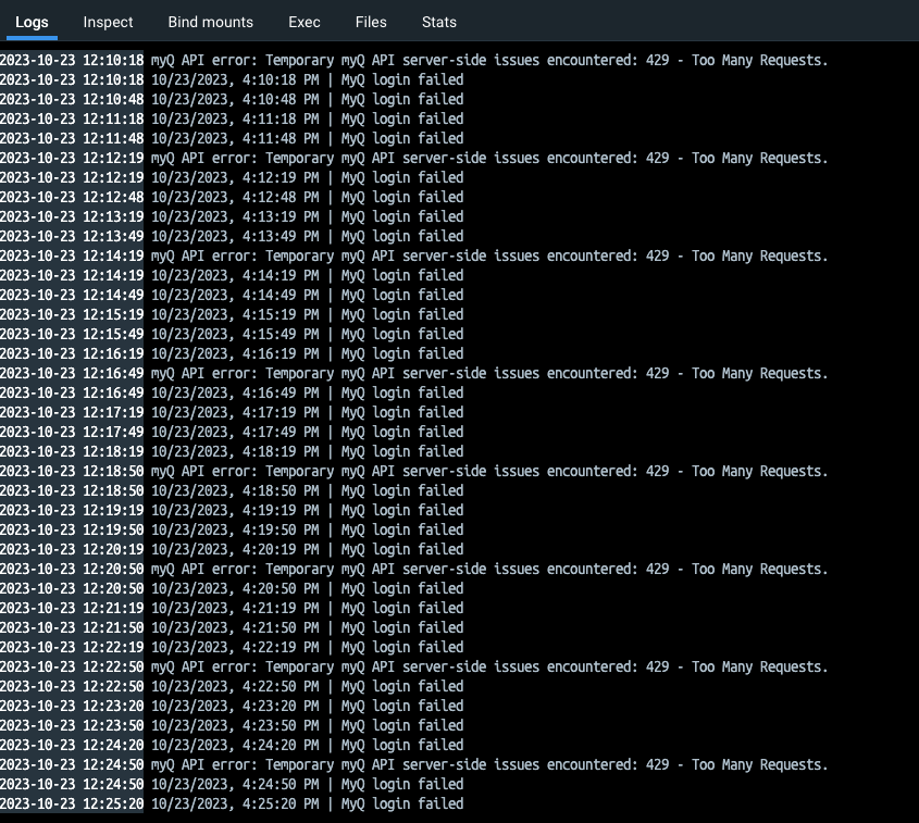

Hey @brbeaird … any thoughts on that initial “blast” of log in attempts? That would certainly appear to a Server to be a bot of some sort. Any way to prevent that from happening?
@BartschLabs … did you get the “blast” of 429 errors that I saw? (this post)
Hit with 429s this morning. I stopped at 9a so we’ll see how long it takes. I was thinking of attempting at 10 hour mark as a test. I can go longer or shorter to help any testing needed.

No, just the typical 2 Login Failed and then the API Error, on repeat.
