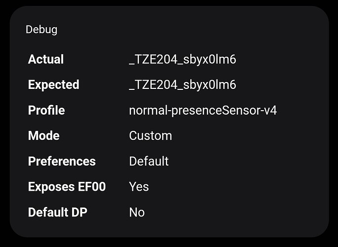

Hi @w35l3y
I use your driver with the zigbee ceiling variant of this presence sensor.
Zigbee Wifi Mmwave Menselijke Aanwezigheid Bewegingssensor Met Luminantie/Afstandsdetectie 5/110/220V Tuya Smart Life Domotica - AliExpress
The presence sensor is recognized and it works fine, but I can only use it in a routine, to switch lights or whatever. I cannot use it to trigger an alarm in security mode. Is it possible to add an option that you can also use the driver as a motion sensor instead of a presence sensor. I think I then can select it as a sensor for the alarm?

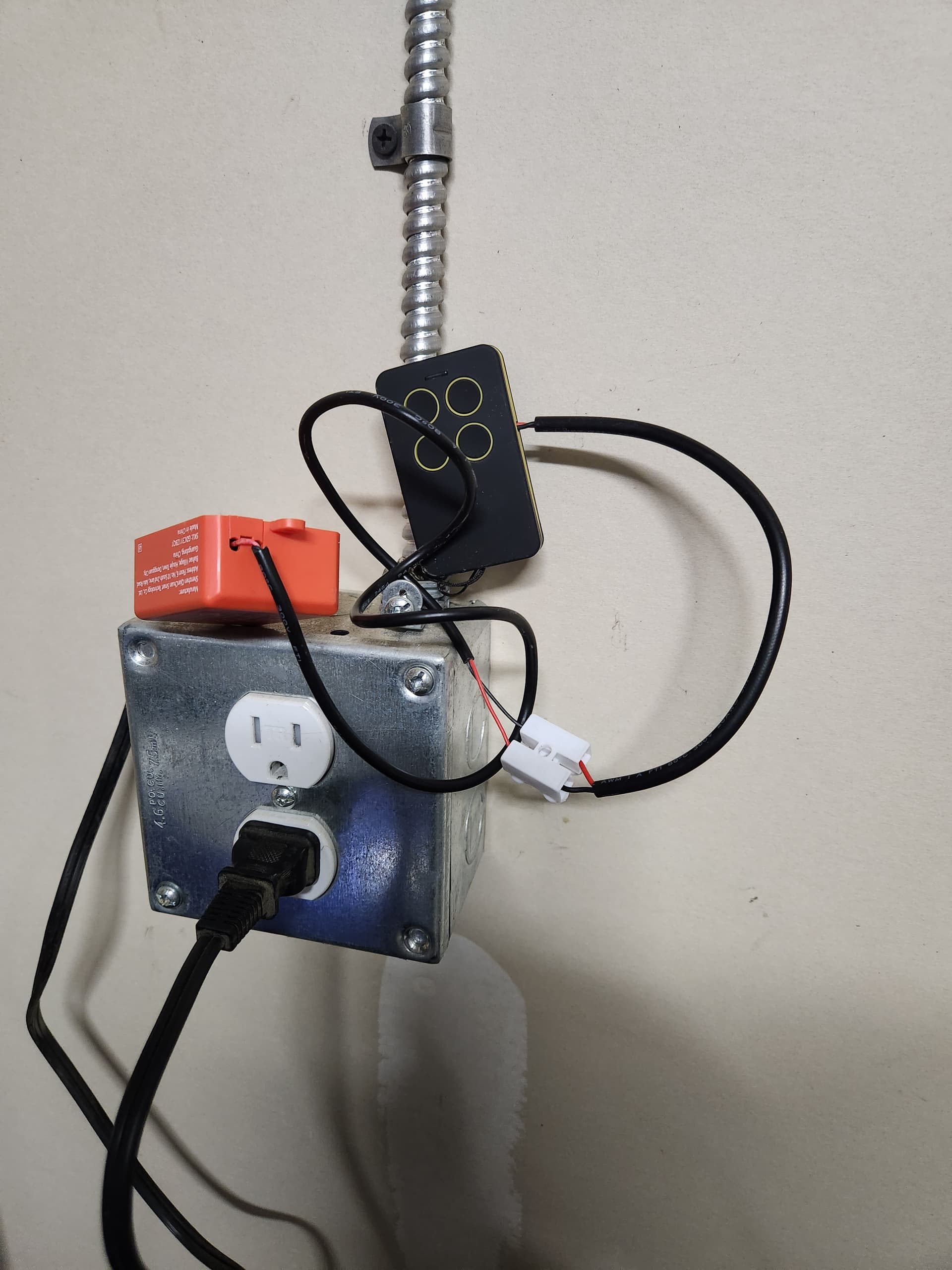

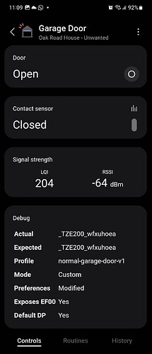

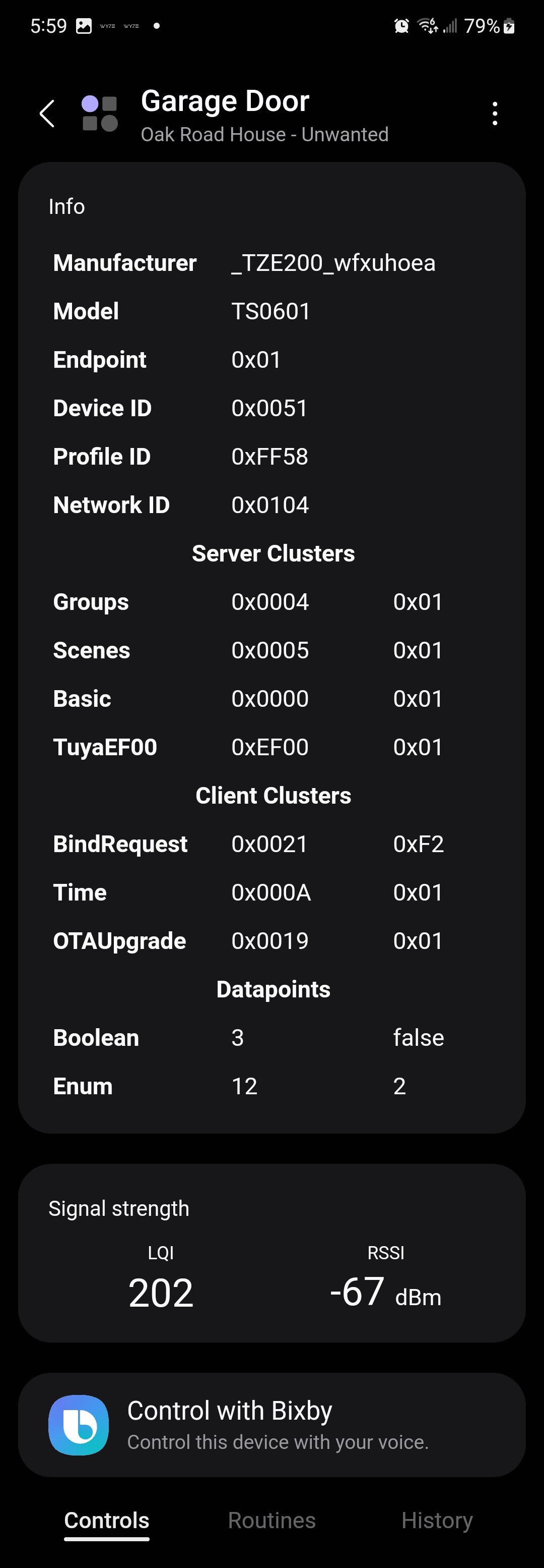

Thanks for all your work building the driver. One of the devices i use with your driver is zigbee garage opener. Button works fine, it opens and closes the door and contact sensor is accurate. When someone uses the the physical garage door button or a remote clicker, door state goes out of sync even though contact sensor shows correct state. Is there a way to sync garage door and contact sensor states?
Thanks.

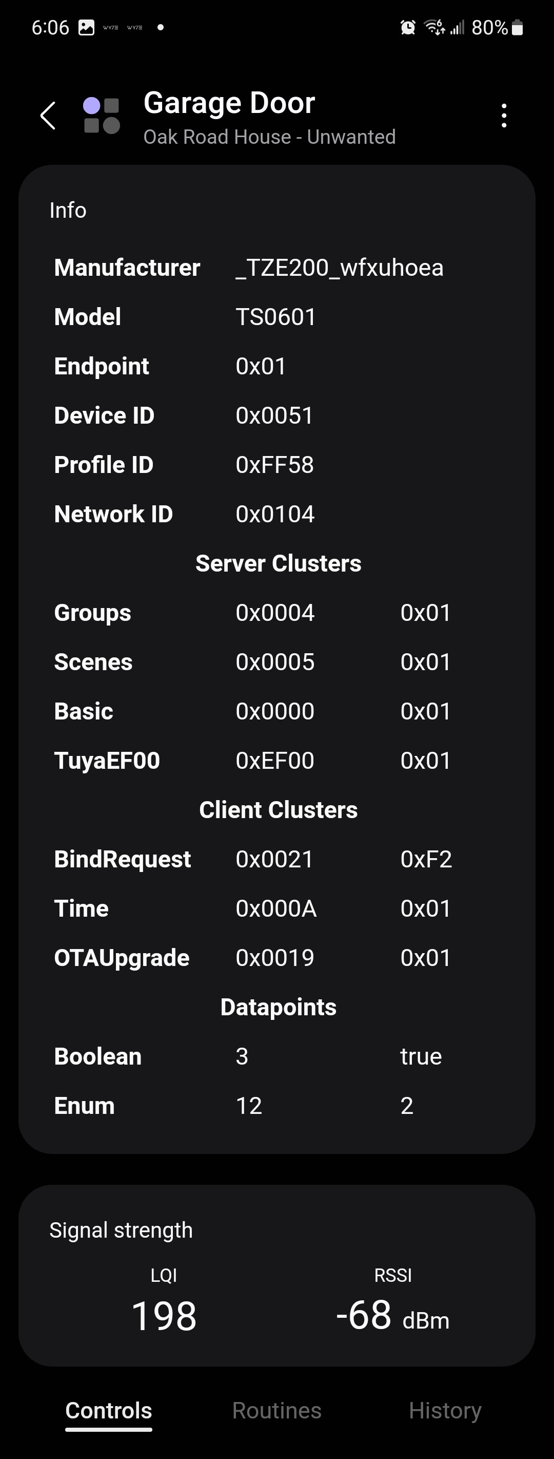

Open it in generic mode, keep looking the datapoints list in the app and press the remote control.
Then let me know the results of the test above.

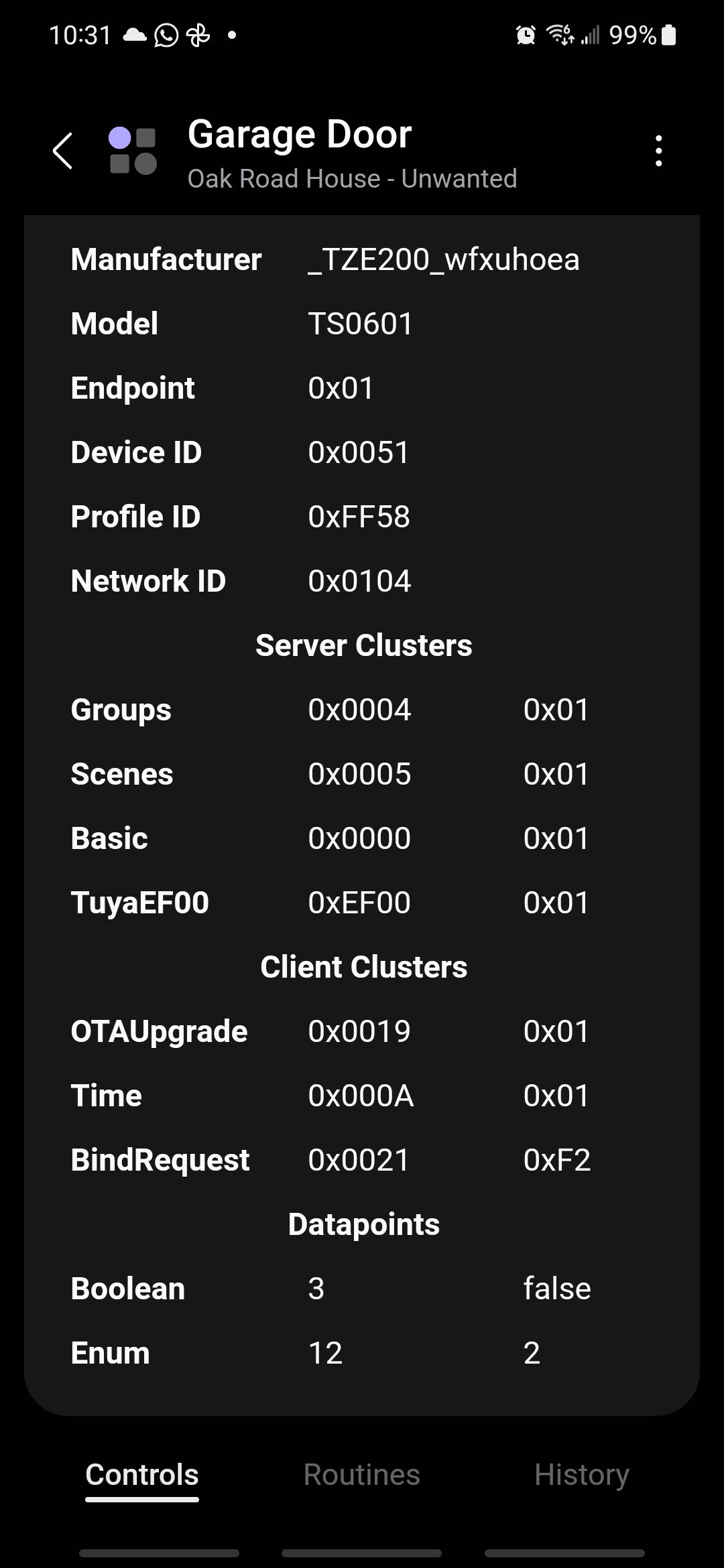

Hello,
I put it in Generic mode, pressed the wall switch and clicker a few times. below are the screenshots. The only change i see is datapoint 3 changing between true and false depending on garage door position. Little more info on my setup, my opener is connected to a remote as shorting the contacts on the back of my garage door nothing. Pressing this remote button didnt add any more datapoints.
It explains the reason why the driver didn’t sync.
The driver bahaves based on received informations.
If it doesn’t receive anything, it can’t do much other than wait.

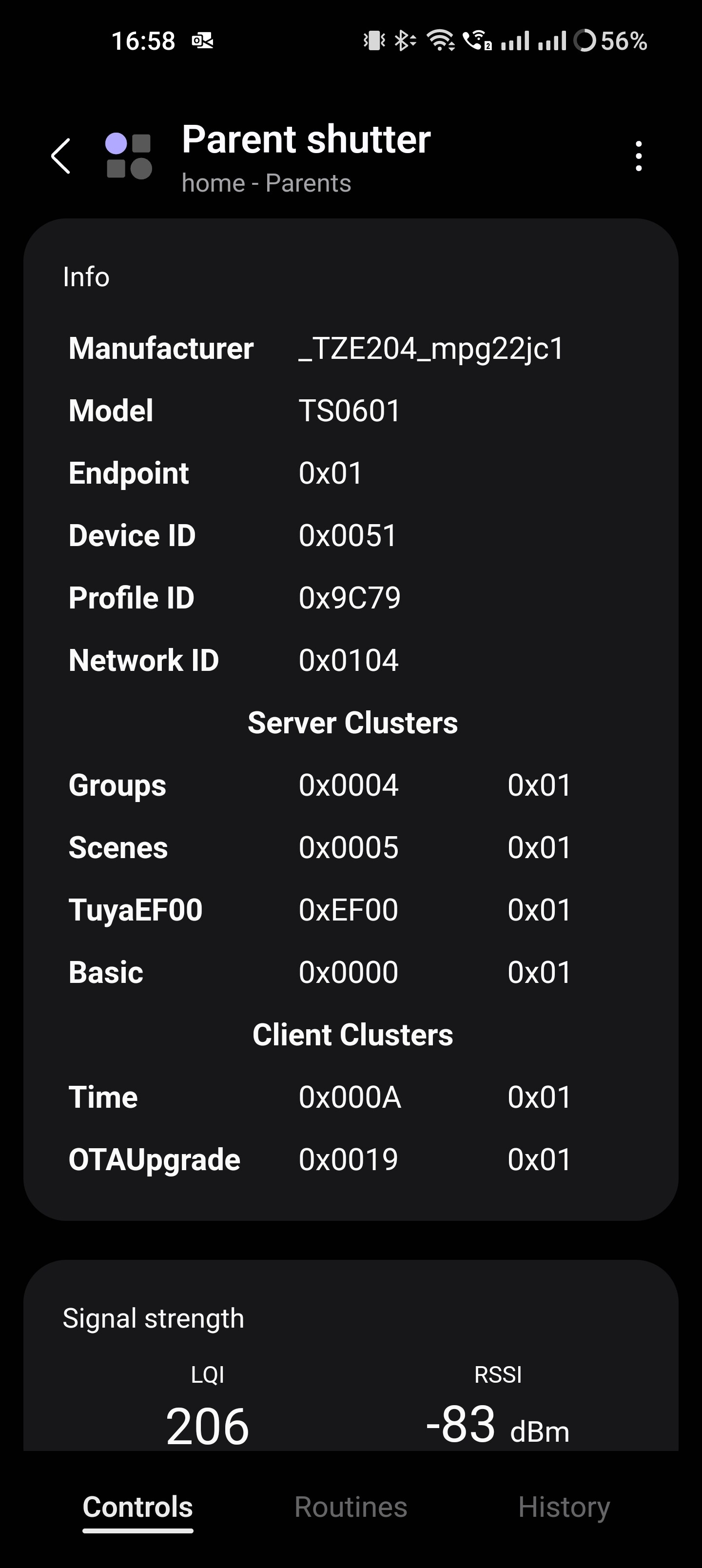

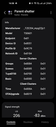

Hello.
Please help. I have zemismart touch curtain that I can control and cant calibrate. Properly.

Can someone help with this.
I want the driver to work and I could open and close the shutter.
It also says allways its partly open

Consider using the generic mode to calibrate it.
Otherwise, you may buy a tuya hub just to configure the settings and then pair the device with ST. Your settings will be kept the same.
