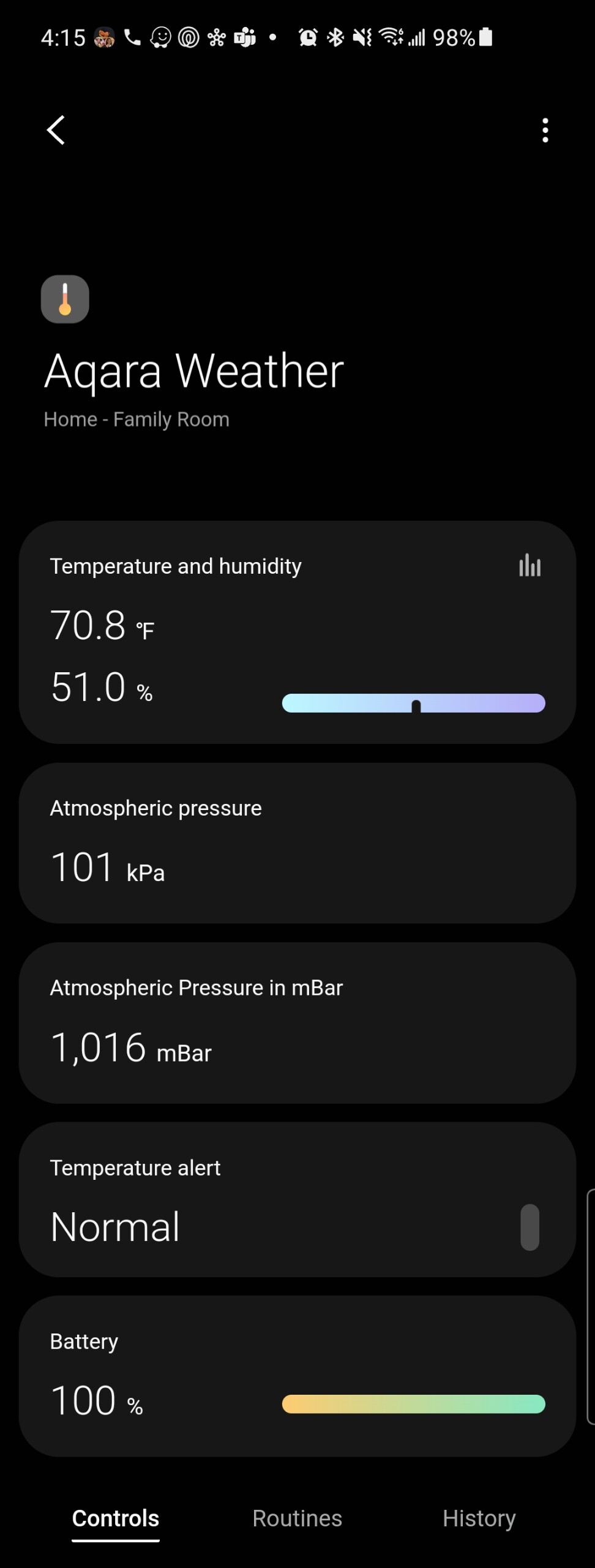

Currently I have 3 different drivers for Aqara’s Temperature Humidity Sensor
First one is @veonua’s driver that he created at the time of Beta Edge rollout. Driver works for basic functions. However icon that he uses is for Contact sensor, and capability Temperature Alarm that he uses is hardcoded - not setable by user. Usless feature if you don’t know what triggers that alarm. When I approached him in one of the threads, he stated that drivers were created as a proof of concept that they work, and he will not support them, or further changes.

the icon is fixed now
As for temperature alarms - almost every Aqara smart sensor has a temperature reading, but other sensors have poor precision, so it’s good only for extreme temperatures freezing <0* or overheating >50*.
I am using this alarm as a security measure and hope the hub will send a notification in case of emergency.
@veonua it would be useful if Temperature Alert is settable, as I might want to get alert before freezing point 0°C (32°F), for example at 34°F. Someone else might want warning at -5°C.
Same for Heat. Users have different needs.
