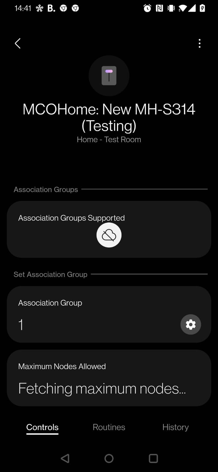

I downloaded it and went into the detail, these are the screenshots, but not knowledgeable enough on Zwave to draw any conclusions from it:
Not sure if Group 3 is the lifeline association you have been mentioning: here it is showing Nodes as EE.
Actually, I set up all 6 switches which are now on Edge to the Associator driver, and I realised this: all switches have an additional Association Group (5 for the 4-button switches, 3 for the 2-button switches). And - tellingly, the Nodes on all the switches working well was set to “01”, whereas the Nodes on all switches not working well was set to EB, E7, and EE. This with one exception - the new MH-S314 which did not manage to query the switch, seemingly, and remained like this after 2 attempts to set it to the Associator driver:
But - yes, it seems your suspicion is correct, and likely I have no means of setting that Nodes field of the last Association group to 01.

I will wait for @philh30’s new code that tries to wipe and update the Lifeline Association - otherwise, it would mean having to swap the driver on all already-converted switches to say the ST-provided Zwave Switch driver, then removing all compatible drivers installed thus far, then excluding and re-including each device and hope everything goes well with re-including them with a DTH, assign them the Zwave Tweaker 2, assigning the Lifeline Association, re-exclude them, install the Edge drivers again, then re-include them. It just seems like a lot with plenty of room for error. So I’d rather wait a bit and see whether the change can be forced through code.
It’s coming. I just need to figure out the logic for the configurable wake-up poll. I think I’ve got the lifeline group worked out where it’ll keep trying to clear and set it until the device reports that it’s set correctly. It should work on the first try though - what’s missing from the current version is just clearing it first (but I don’t want the driver to automatically clear it until it knows it’s incorrectly set). I’ll maybe have something ready tomorrow if I can find time to work on it. Hold off on migrating more devices for now.
