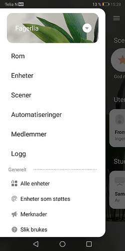

From the Home screen, touch Menu
Touch Supported devices
Touch Sonos
But Sonos is not under supported devices in the apps.
What am I doing wrong?

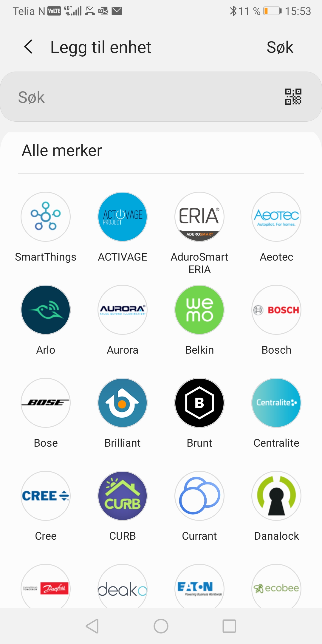

You can add them by tapping the + in the upper right of the home screen and choosing Add Device and then Sonos. Make sure your Sonos speaker is on the same local area network as your hub.
The brand list is regional, so it may not be technically supported for your country. But its a LAN discovered device, so it may auto discover. Try choosing the Belkin Wemo brand and going through that setup and see if SmartThings happens to find your Sonos devices.
I think it’s ‘Søk’ in the top right of your screenshot. Some people have reported that it gets to 60% through searching and then stops, but when they go back to their device list they see the new device. (Mine did this and the device was all the way at the bottom of the list)
You’ll want to make sure your SmartThings Hub and Sonos are on the same local network when doing the discovery.

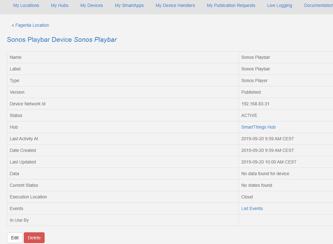

Just noticed that when I try to add devices in Smartthings Groovy IDE, Sonos is under devices!
Just added two of my speaker using IP address. If this work I guess I need to reserve these IP’s.
