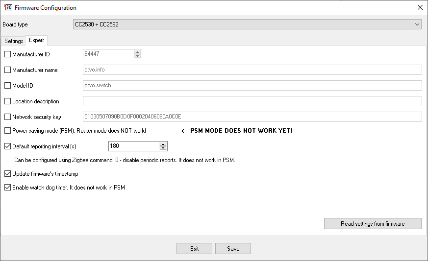

FYI, ptvo (ptvoinfo on GitHub) has tools that allow you to relatively easy modify CC2530 Zigbee router firmware yourself:
Zigbee Switch Configurable Firmware for Texas Instruments Z-Stack Home 1.2

See ptvo (ptvoinfo on GitHub) Zigbee Switch Configurable Firmware tool for Texas Instruments Z-Stack Home 1.2 for a good summery of what you can do.
Check out its features summary page:
Again first read
and also read
This firmware allows you to create a Zigbee switch device with a flexible configuration of inputs and outputs.
You can, for example, change basic things like:
- Remember state â If the firmware should save the output state to NVRAM and restores it after power off/on or not.
- Link â The input immediately controls the state of the corresponding output. The device sends the on/off state of the output to a coordinator. Otherwise, the input is independent.
- Long â The firmware detects and reports to the coordinator a long click (2000 ms).
- Double â The firmware detects and reports a double-click (max 500 ms between clicks).
- Triple â The firmware detects and reports triple-click (max 500 ms between clicks).
- Long - The firmware detects and reports long-click
- Status LED indicator changes
Then you could technically also use its more advanced functions, it does, for example, have an I2C interface so you could, in theory, connect external sensors (such environmental temperature and humidity sensors, like DS18B20, BMP280, BME280, DHT11, DHT12, DHT22, AM2301, Sonoff SI7021, MHZ19, SenseAir S8), but some such functions like external sensors might also require hardware modifications like electrical isolation for electrical safety. Again much more info in the linked pages for ptvo firmware tool.
