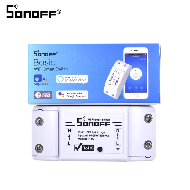

I asked because the box of them is different. one of them like this
about flashing :: I used FTDI …
I bought this one https://gloimg.gbtcdn.com/gb/pdm-product-pic/Maiyang/2018/01/19/source-img/20180119153917_69252.jpg
And I’m worried that it does not work with IFTTT. Because I want connect it with Smartthings HUB
Yeah they’ve re branded the boxes I did notice that but the device is the same.
If you leave it as it is without flashing it I don’t think it will work with ifttt but when it’s flashed it will as it’s through SmartThings then.
