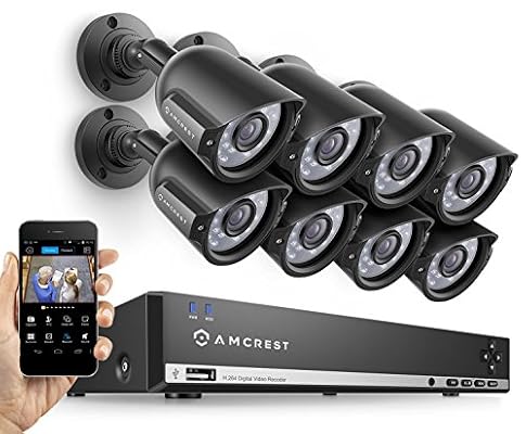

Do these cameras happen to work with SmartTiles?
I ordered one to play around with as an alternative the the Dropcam Pro’s I have. I’m tired of paying a monthly service for them.
Can someone review this and let me know if these cameras will be able to be viewed on SmartTiles?
They are not IP Cameras so I think they answer would be no.
That was my concern, but they are networked and accessible from browsers, so thats where my question stems from.
Yes… you are correct to believe that these quite likely might be compatible.
But SmartTiles does not provide User Support for Video; find the actual detailed specifications and user manuals (probably downloadable from Armcrest vendor) and/or call the vendor’s tech support, and find out if HTML5 non-plug-in MJPEG http video streams are provided. That’s the only type of stream that generally works fine (but not always).
Flash, ActiveX, etc., work “in the browser” but generally do not work in SmartTiles due to plug-in issues.
RTSP does not work “in the browser”, but there are transcoding services and transcoding servers you can run at home … and this type of system should have that built-in, but you have to ask the vendor directly.
I personally recommend Blue Iris Software (from Foscam?) as it supports many cameras and I believe does transcoding and can be run on a pretty cheap mini-PC. Total cost is a bit higher, but expandable and flexible (you can use many camera brands, etc.).
Thanks for this info. I do have a camera software but cannot recall what the name is, as I was trying to get a dome camera working (but failed).
I can do more research on these cameras, but youre probably right with regards to access via browser is probably plugin reliant.
