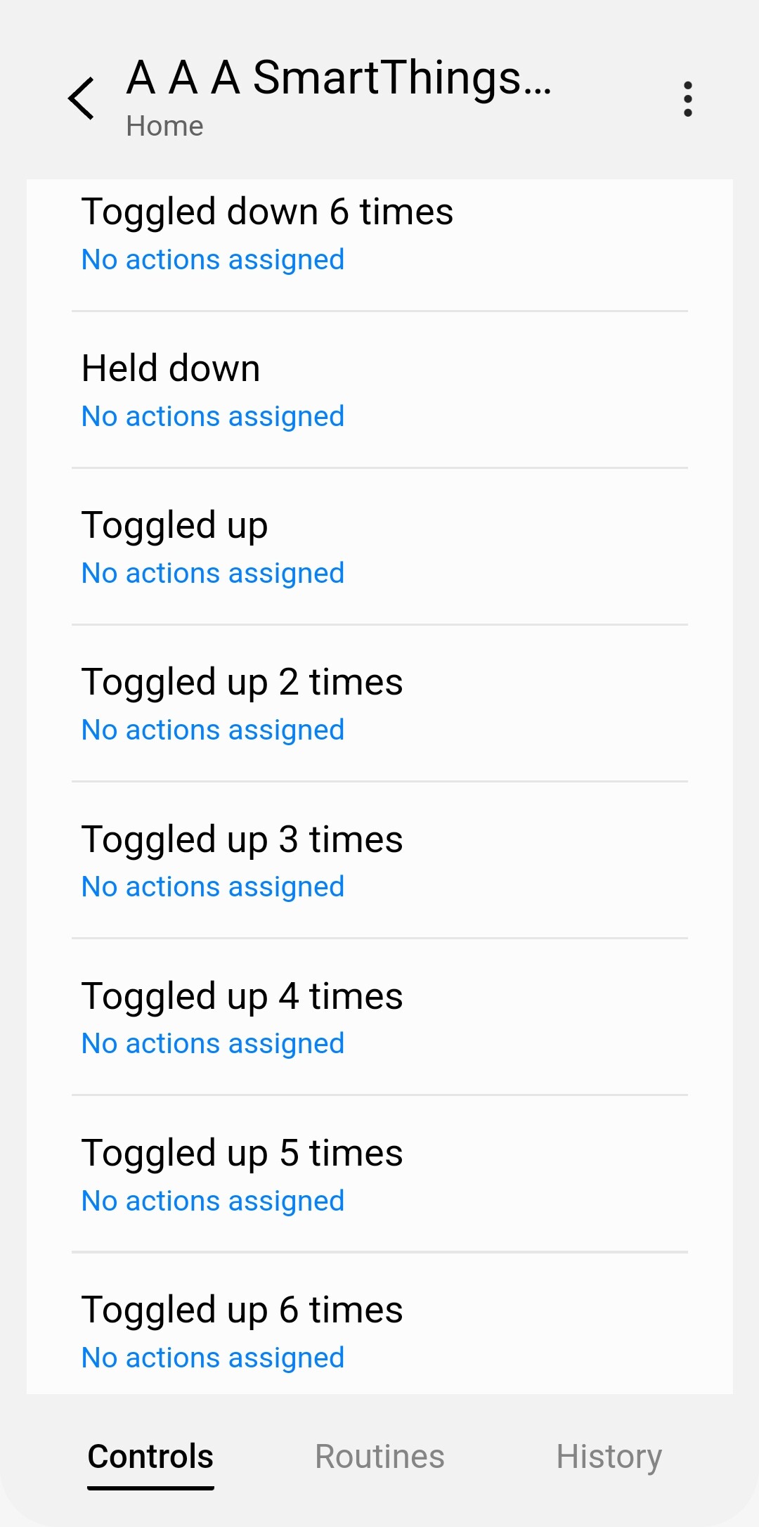

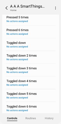

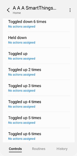

Instead of 4 buttons with only single capability “Pressed”, now it’s showing 21 capabilities for each button.

Device Automations on Details page, are still showing incorrect automations for rest of the buttons under button #1.
It is said in tread related to driver’s release, this drivers are released after testing, but I am not sure how are they tested, on a virtual device, or on actual physical device. Here is the screenshot of device.

It’s a UI plug-in issue impacting all multi button devices. I’ve reported it to support (ticket 1282487) and they’ve acknowledged it’s a bug. Your best bet is to report it to official support channels (support@smartthings.com) to add to the urgency.

If you’re referring to the long list of button enums shown in the detail view, that’s an issue that is affecting other integrations, not only Edge drivers. It is related to the plugin, not the configuration itself.
