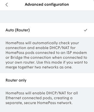

Thank you for the info! Looking at my Plume app, I do see the following if I go to: Adapt / Advanced Settings / Networking Mode:
I find the wording confusing. It has always been in ‘Auto (Router)’ mode with it being directly connected to my Comcast modem (which itself is in Bridge mode).
From the way it reads (if I’m reading it right), it seems like it’s smart enough to know whether it should be in Bridge mode or not and will automatically set it that way? When I get my new Deco mesh, I plan to plug the main one directly into Comcast modem (same as current setup), then plug the main ST WiFi Mesh Hub into a Switch that comes off the Deco unit.
It’s just odd there is no direct Bridge mode for the ST WiFi Mesh hub, and would it really turn off its WiFi? Thanks for any help/advice.
Strange, my options for Networking Mode are worded Auto (Bridge) and Router only, but the description for Auto (Bridge) is the same as yours.
