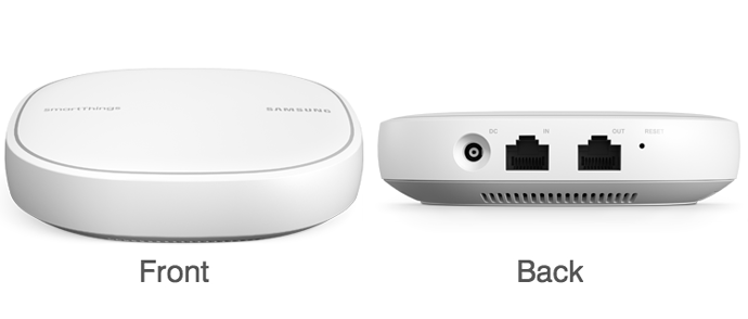

If you want one that can create a Wi-Fi mesh network, it will need to have “Wi-Fi“ in the product name.
Also, there are two generations of the Wi-Fi mesh product. Make sure you get the one that uses plume, that is the current generation. you do not want the first generation. (The first generation isn’t even listed in the following article.)

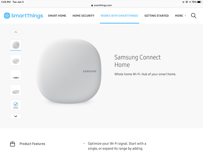

The first generation did not have plume. You can tell the difference because the first generation had only one word, “Samsung” on the cover, and the current generation has both “Samsung” and “SmartThings.”
1st generation: (Samsung Connect Home)
2nd generation: (SmartThings WiFi)

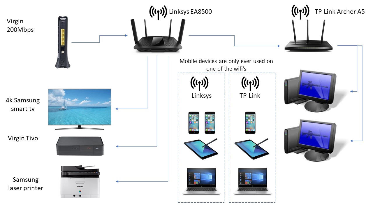

I have attached a house layout and network diagram. Reception at each end of the house is sketchy or non existent if the wind’s in the wrong direction. Both PC’s are used for gaming so currently have hard wired LAN from the TP-link network.
My plan was to use a MESH system with the existing LAN cables (nightmare to move) for backhaul and connecting the PC’s, if the units only have 2 Ethernet ports i would add a switch or splitter where needed. I need at least 3 network devices, possibly 4.

You have a challenging environment to work with for any product. 2.4 ghz wont handle brick well and 5ghz will handle brick even worse. The first thing I’d check is to make sure your not stepping on your own WIFI feet. If your linksys in on channel 1 or 6 and tp link in on channel 6 or 11 And both are not using 6 then you are pretty covered there.
As far as mesh wifi goes Netgear orbi is solid and has a wired backhaul that you’d want to use because the standard 5ghz backhaul wont get you very far. Because it’s a mesh system you get centralized management but it’s more money than you stated you want to spend.
If you are ok with running some extra cables the TP Link A5 is a solid, inexpensive device. If you added 2 more or the even cheaper c50(no need to be fancy), one to each each room with flakey wifi, gave them all the same ssid and passcode and wired them to your linksys. Then setup the 2.4ghz manually to be from bottom to top to left 6,1,11,6. You’ll also want to ensure all of your TPlinks are in AP mode not router mode or it will cause lots of other problems on your network. It will be more difficult to manage but w/ 2x TP-Link c50, a switch, and some cable you should be able to get more stable wifi for under £100 and create your own WiFi mesh.

If i add more TP link in AP mode all with the same SSID will devices easily switch to the best signal as they move around the house or hold on to the one they started with for as long as possible? I had the two routers set similar to that previously although it’s quite possible i did it wrong / badly. When someone was using facetime and walked around the house it didn’t switch between points. Now i have their devices set to automatically connect only to the point closest to their rooms.
I might have a way to get a cable closer to where my desk is and that would cover one of the upstairs parts of the house. We have 3 upstairs, it’s a really old house that used to be farm buildings.
I’ll search the web again with your device recommendations in mind.
Thanks again.
Most devices will failover from AP to AP somewhere in between these 2 options.
If this is the case and not a typo, that is a VERY strong signal. What ever channel you see a 0dbm ssid on avoid it! If you have a neighbor pushing a signal that strong through walls it’s prob an illegal very high powered device or your linksys detecting itself.
One of the reasons the mesh systems are so much more expensive is that they track device signal strength across all AP’s in the mesh and are far more aggressive about disassociating a device from a weak AP and re-associating the device with a better AP. They can also minimize interruption of the data stream as you switch from AP, to AP. If youre goal is to stream video or game w/o interruption As you move across your entire space, mesh is the best/only option. If you want cheep coverage across your entire space and dont mind minor interruptions as devices transition across AP’s at the devices discretion, then add some cheep AP’s. Keeping the SSID and passcodes the same across AP’s just makes it easier to manage.
