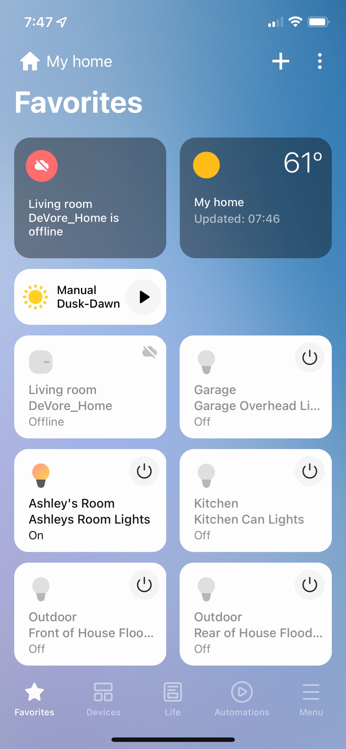

Current situation:
  1. Wi-Fi working flawlessly over Asus Zen network
  2. SmartThings app shows that the network (DeVore_Home) isn’t connected.

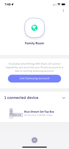

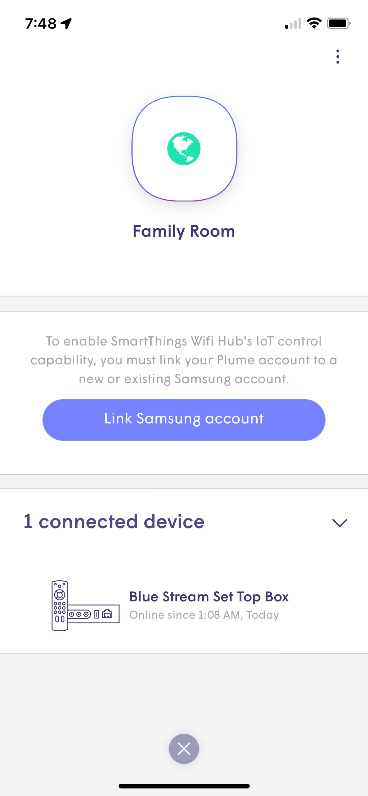

  3. Plume shows the network is created and connected and is in Auto (Bridge) mode
  4. Plume also shows that I need to link to my Samsung account for IoT devices to work (which I’ve done so many times Samsung had to call me with 2-step verification because it said they had texted codes too many times)
  5. Strictly time-based automations have magically started working again
  6. Automations with triggers from Zigbee/Z-wave devices aren’t working.
  7. Zigbee/Z-wave devices have disappeared from SmartThings app
  8. Automations containing Zigbee/Z-wave devices have disappeared from SmartThings app

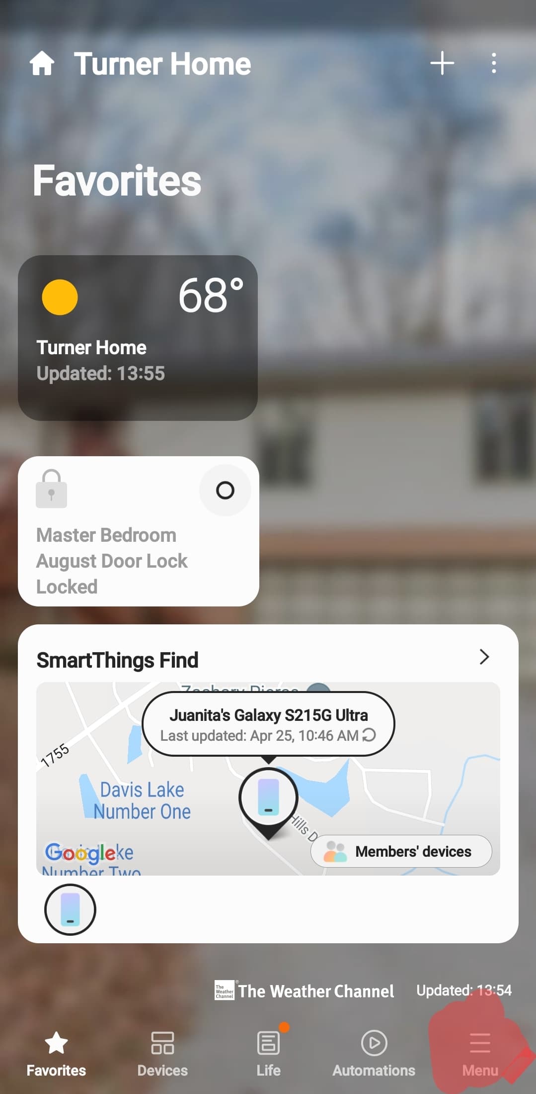

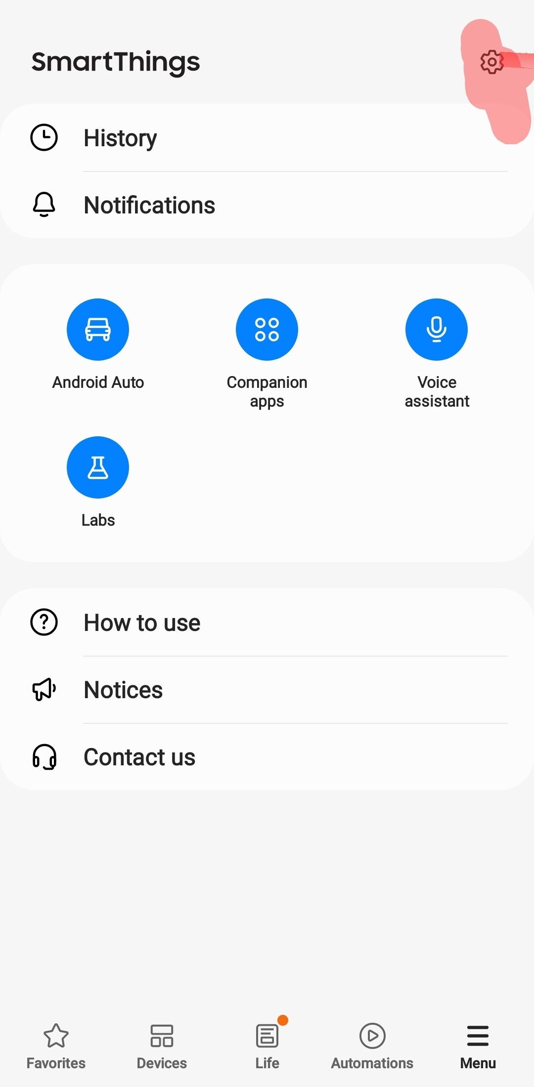

Might not be relevant to your situation, & it might sound ludicrously silly…But, did u check that your logged in to the correct smartthings email? I’ll lay out the steps, not because u sound like a novice, but to ensure we are on the same page.
Edit: After posting I noticed the pictures were in reverse order sorry, start at the bottom and work … you know what I mean!!
Thanks for your thoughts. I have confirmed that I’m logged into both SmartThings and Plume using the same email address. The one difference I see between what you posted and what I have is that the ST app won’t even allow me to login with Google account. I toggle that switch on, but it won’t allow me to set it up (and I’m using a gmail account for my Samsung account).
