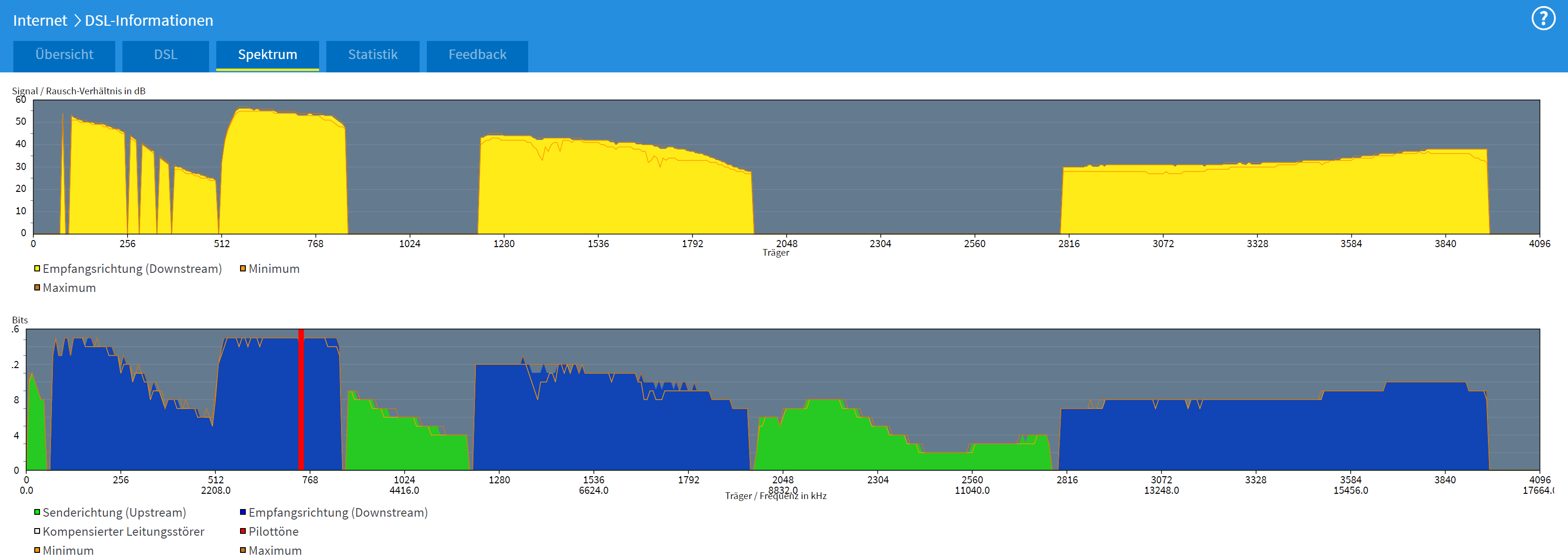

EDIT: I was talking about the DSL Spectrum and not the wireless / wifi spectrum.

:smiley: Yes, I’m talking about DSL. Here in germany Internet over Copper wire is the standard.
No, he was talking about the DSL Spectrum: Here is a example how it can look. The picture is a random example and from the same device, but it should make everything more understandable:
https://www.computerbase.de/forum/attachments/screenshot_79-png.753367/
