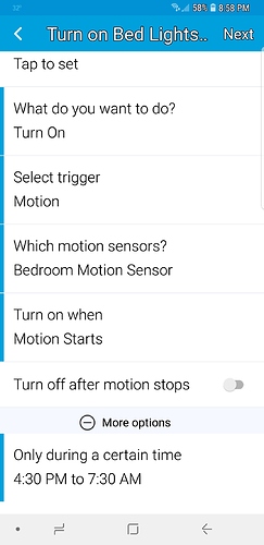

All the sensors are working now. Except that they come on outside the times I have set specifically in the automation. Basically these things work when they want to. I’ve removed the battery and reset the sensors and after doing so nothing happened. Except during the day do they come on when I have the automation set between the hours of 4:30pm-7:30am. The bedroom sensor doesn’t seem to want to work at night. The other two work as advertised. Is there something I’m missing here? The only thing I haven’t tried yet is resetting the hub. Which I’m not sure I want to do as I have a whole home full of lights that I’d need to add again.

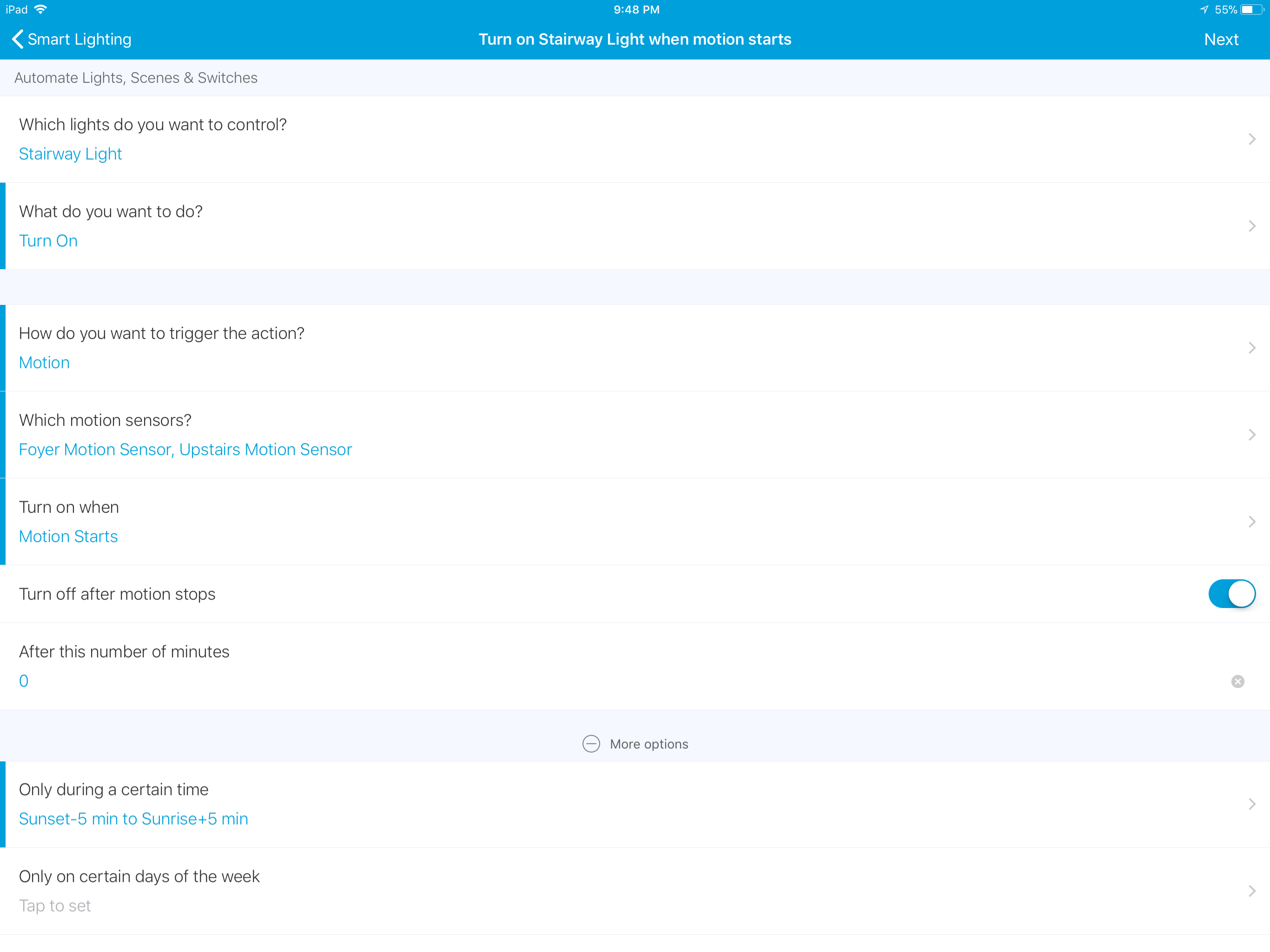

What app are you using for turning the light on with motion? The Smartthings Smart Lighting app?
Yes! Sorry I forgot to mention that. This thing is just random. It seems to be working fine now like it was when I first set it up. It’s just that it’s not triggering at the specified time. It just triggers all the time. I just want it triggering when it’s dark out.
