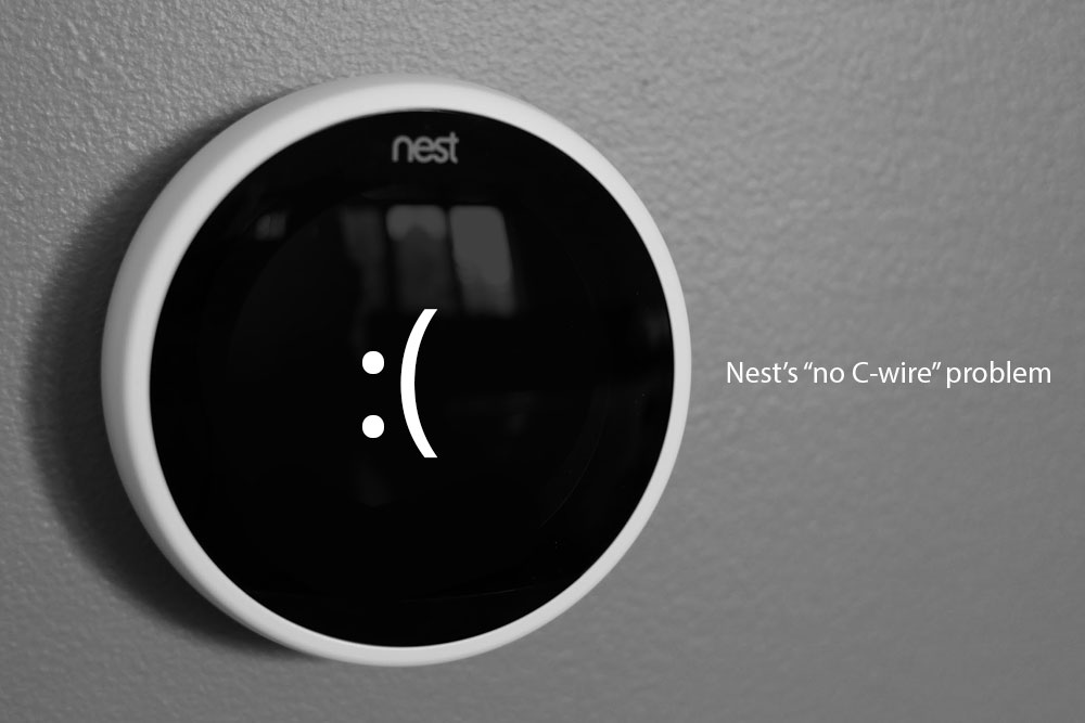

I forgot to mention that if your furnace does not have a “C“ wire, at first glance it will look like nest is a better choice because it does have an option for that configuration. However, there have been a lot of complaints about the method that it uses for powering the thermostat without a C wire, which is called “power stealing,” interfering with the operation of some furnaces.
