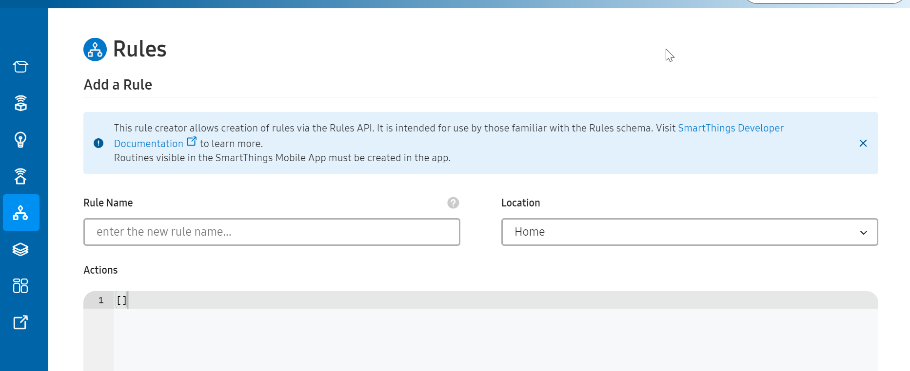

Noted your point on the refresh. By Rules API, I was referring to this screenshot.

I started using the Rules API here this week and it works OK. Have you taken into account that the code you paste cannot include the {name}, as that is entered in the UI?
Just an idea, but as we are accustomed to paste it all in the API Browser, its easy to forget.
