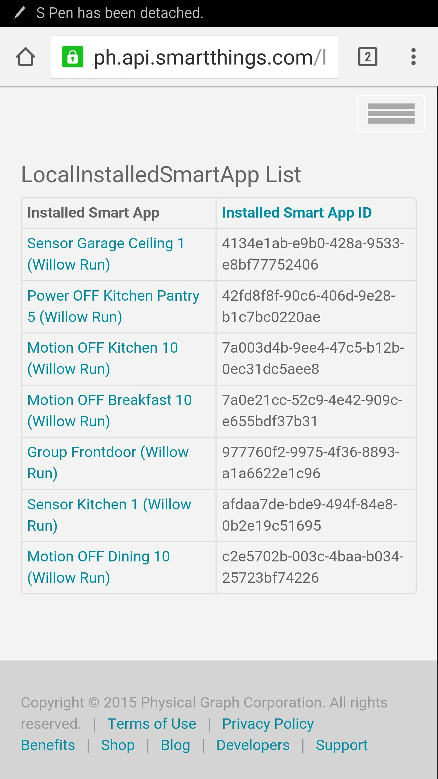

A quick check in IDE showed that some apps are now listed as running locally (even some flagged as “Beta” in Android that “not yet supported for local execution”). I thought that if I go in and change more devices to the “non-local” versions the problems will go away, again. Well, I had no luck finding them. They are not available as templates, not available on GitHub. @slagle, would it be possible to make them available for public somewhere, so I don’t have to chase support? I have non-local for motion sensors, but this weekend I had problems with multi sensors. Also, is there a way to disable the local processing altogether while things get worked out on your end?
