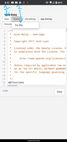

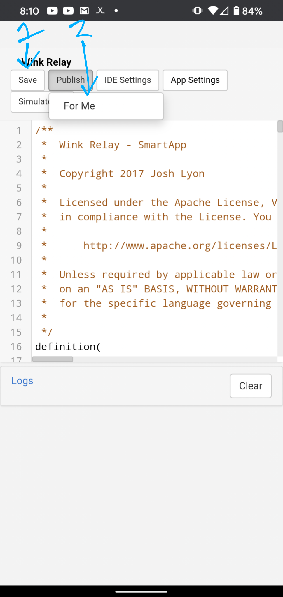

It sounds like you may have submitted a publication request rather than saving and publishing the SmartApp.
That was it! Thanks! Just not familiar with the interface, as yet.
