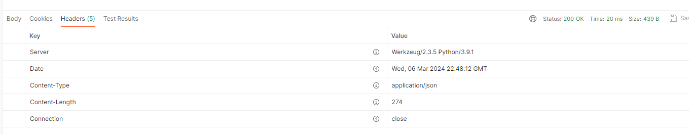

Yes, my app receives the Configuration/Initialize call from ST and then responds to it. I’m able to see the response by replicating the call with postman. Below are the JSON response and headers. ST doesn’t make a Config/Page request as it fails after the Initialize response.
Could you provide more detail on what you’d like to see? I just have a web service which is sending a JSON response back to ST that exactly matches what is in the documentation.
