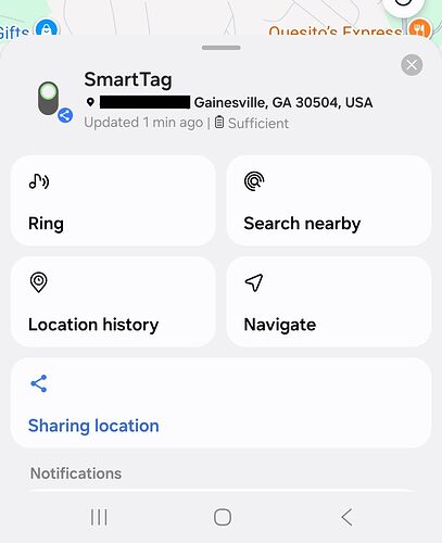

Have you turned on Location sharing for the tags in the ST Find app?

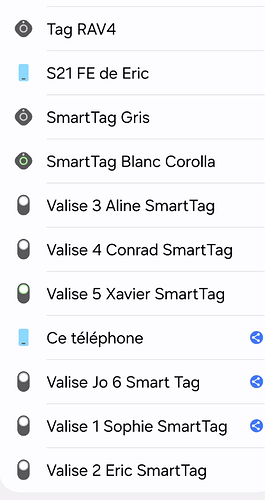

Some are ON some are OFF it does not seem to make a difference but it is ON but only her phone does not pic up the Tags signals, sorry it is in French
You need to go to the “Partage de la position” tab and make sure that “Share location with members” is enabled for each of the tags.
Thanks for your time Bruce, Isn’t that the option to share with some other person so they can fallow your tag also as some are OFF and I get the Ping anyway as you see most are Off and list is longer
If the tags are registered to your phone and you want the location to be shown on your wife’s phone, you have to turn on Location sharing for Members on each tag.

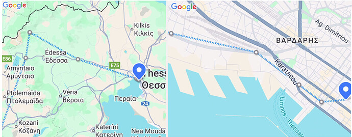

No I want her phone to pickup and relay the ping from the Smart tag she drives for hours, her phone does not pickup pings, but arrives at a stop for Fuel, restaurent, or enters a city and other phones pick the pings
First pic is from 1 to 3 hours between pings and, second pic is entering the city they are all in 15 minutes.
