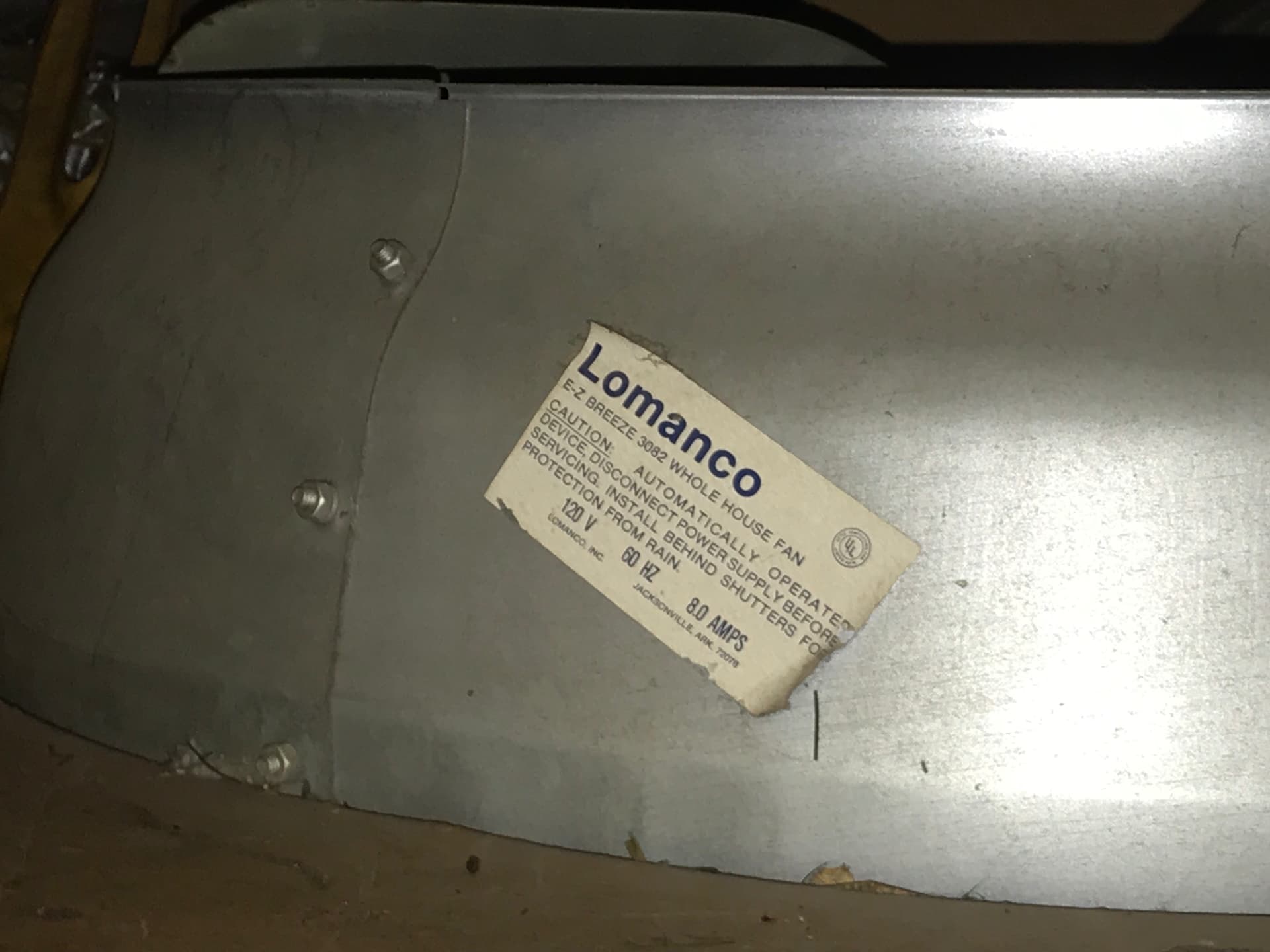

Made by Lomanco. Here’s a pic with power specs.
If you just need on/off you could mount a 120V relay like this one: Z-Wave Isolated Contact Fixture Module - FS20Z-1. Control it with automation or a smart switch

@RBoy - almost certain there will be no neutral and the existing switch supports variable speed control for the fan.
@JDRoberts - your thoughts?
I’m sorry, I don’t know of any zigbee devices capable of controlling a motor that don’t require a neutral.
There are some dimmer light switches that don’t require a neutral, but you should definitely not use those for motor speed control: the physics are different and you can create a fire hazard.
Automating Fan Control--Don't Use a Light Dimmer!
The smartest house has a solution for a whole house fan using a zwave multi relay that you could place along the circuit where there is a neutral. That might be an option. Then you would have to combine that with a switch so that the switch is operating the relay rather than the fan motor itself. You could even do that virtually rather than with wiring, which would give you a lot more choices for the switch, including battery-operated devices.
Zooz is the house brand for the smartest house. Contact their support for information about wiring or other questions on your project.
I know that’s a lot more work than just replacing the switch, and you may not want to go that direction, but with the constraints you’ve given, that’s the only way I can think of to do it. Maybe someone else will have other ideas. :thinking:
