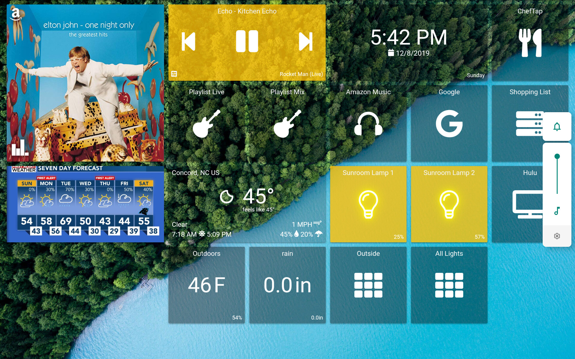

I liked Sharptools from the ease of use but the feeling /look was standard square or rectangular boxes , and is very similar to ActionTiles capabilities. I was looking for some thing where I can add in gauges or line graphs to display the temperature output from sensors or power meters. And the ability to change shape of tiles maybe?
Also I had problems with the media tiles which I couldn’t get to work … I was using a web server on my local lan that works fine from any browser and also when adding a media tile … after clicking new and selecting media (added new media) the new option added was now out of view and the options box not scrollable. see attached image
These could be me not using it correctly , but if the look and feel was more flexible , and could include content such as I have from Grovestreams see attached grove 2 grove1
