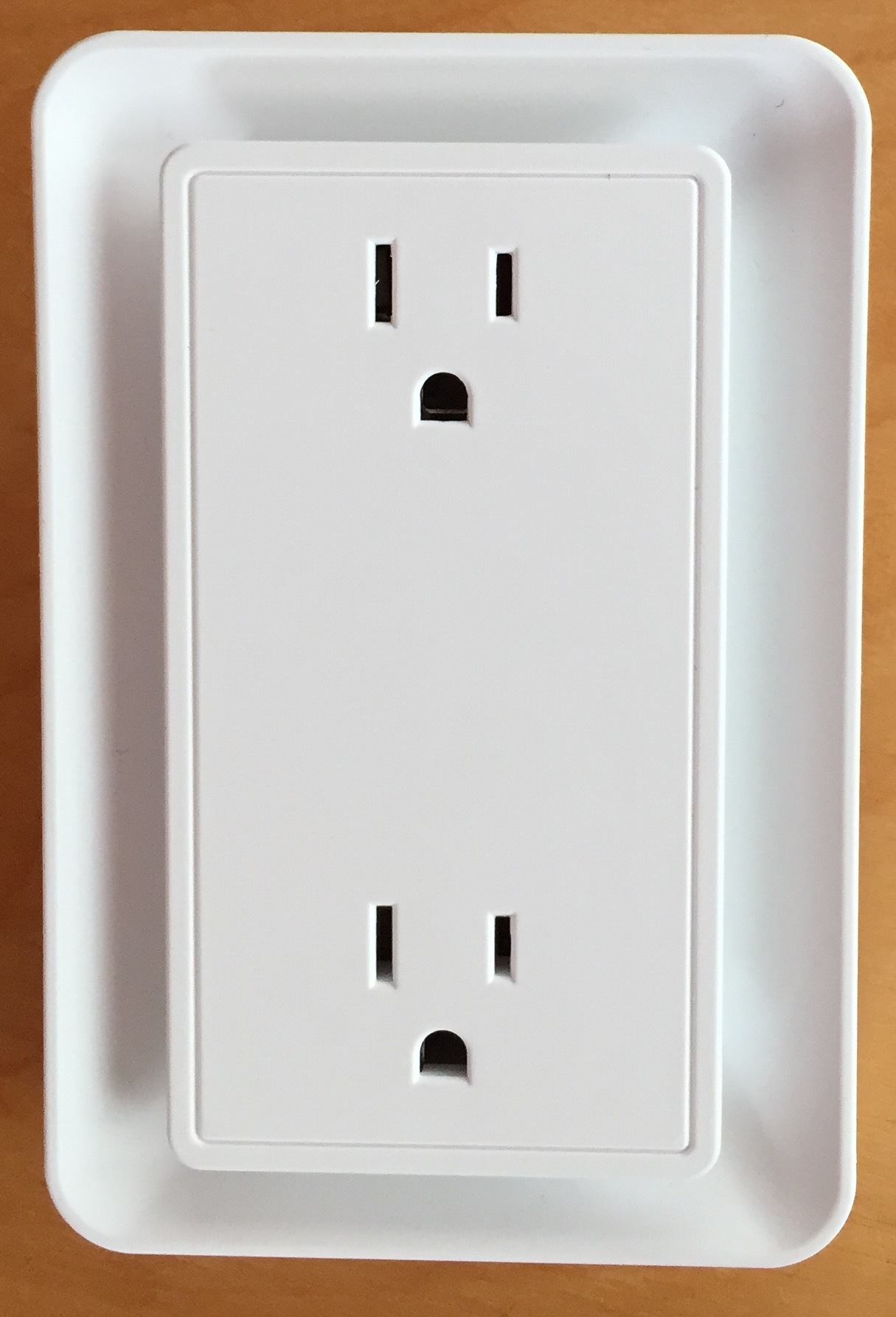

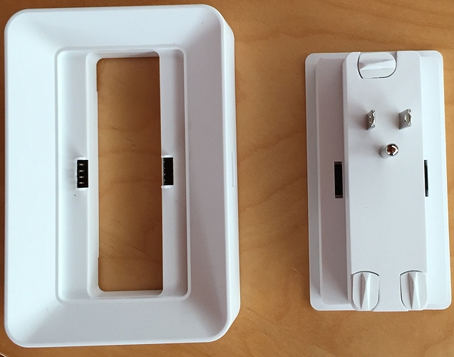

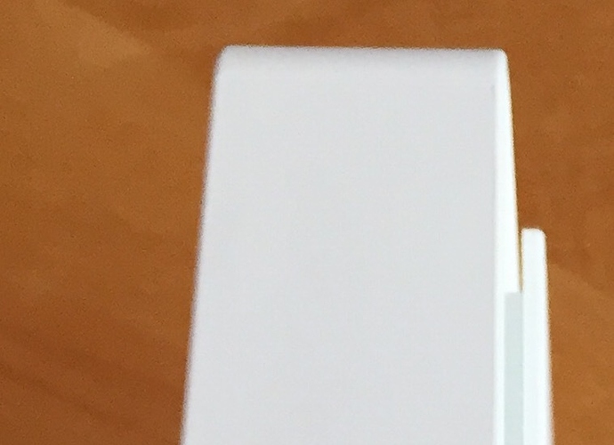

For my order they sent 5-6x10 vents, 3-6x12 vents, 4x12 floor vent, 7-room sensors, Samsung tablet and all the little other things shown in the photos.

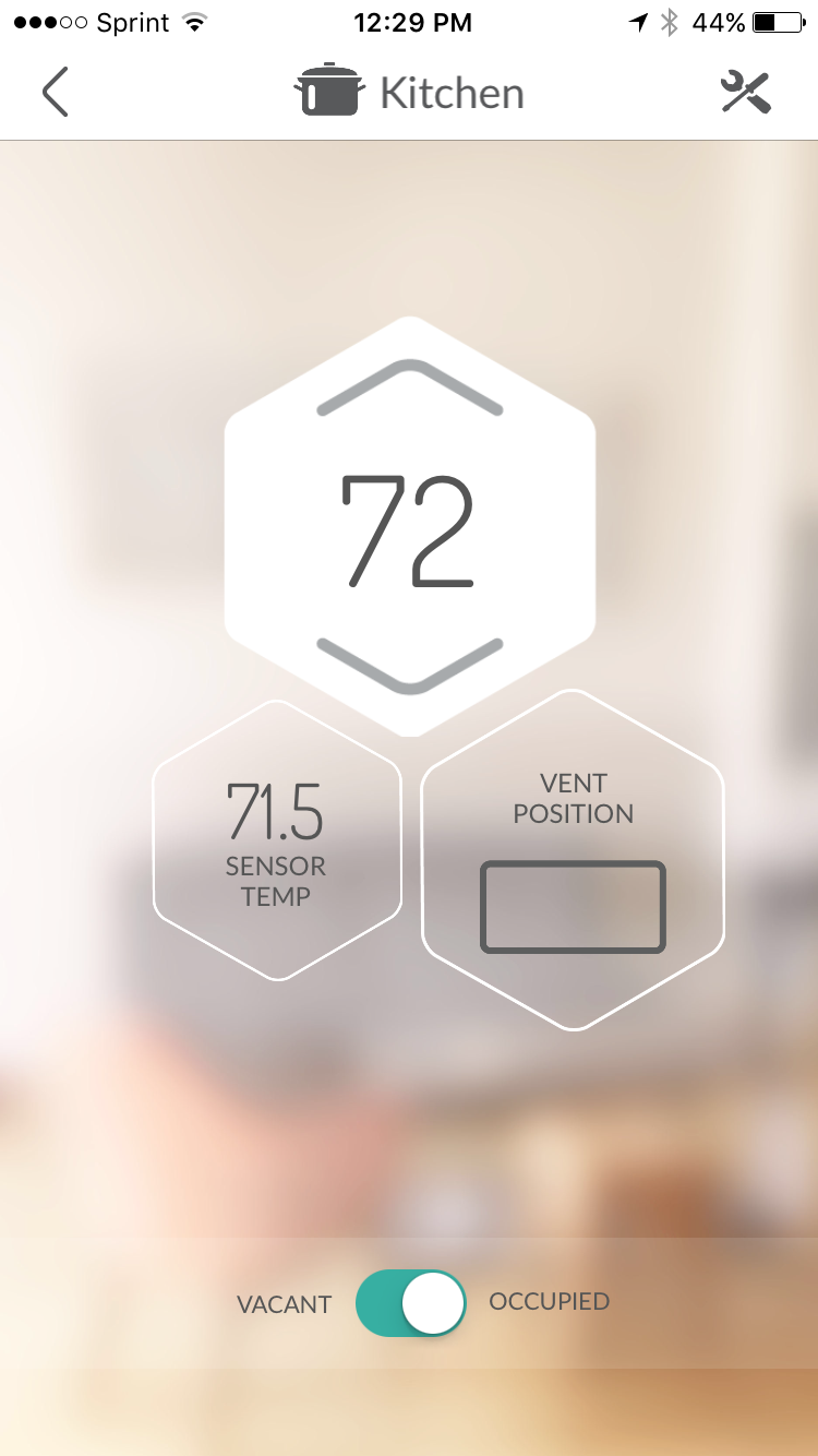

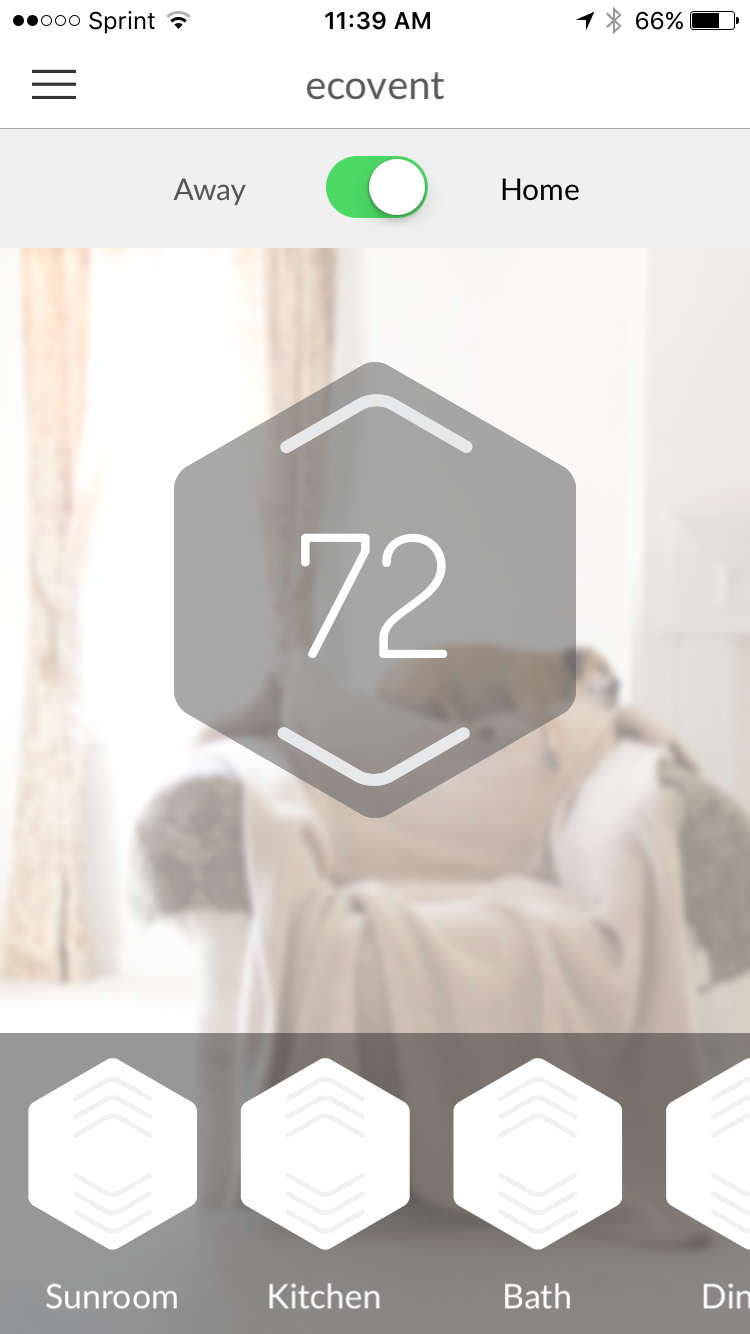

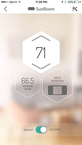

The app looks different from the website because I’m using the Nest. With the big number is the nest target temp. The rooms you adjust them warm or cooler than the nest target temp. With the Sensi I guess everyroom you actually set a temp. My concern here using nest is if a room is cold and ecovent knows it but the nest has hit its target temp the ecovent can’t trigger the nest to call for heat to just warm up that room, because it’s against “works with nest”. With a Sensi I guess ecovent call call for heat to just warm up that room.

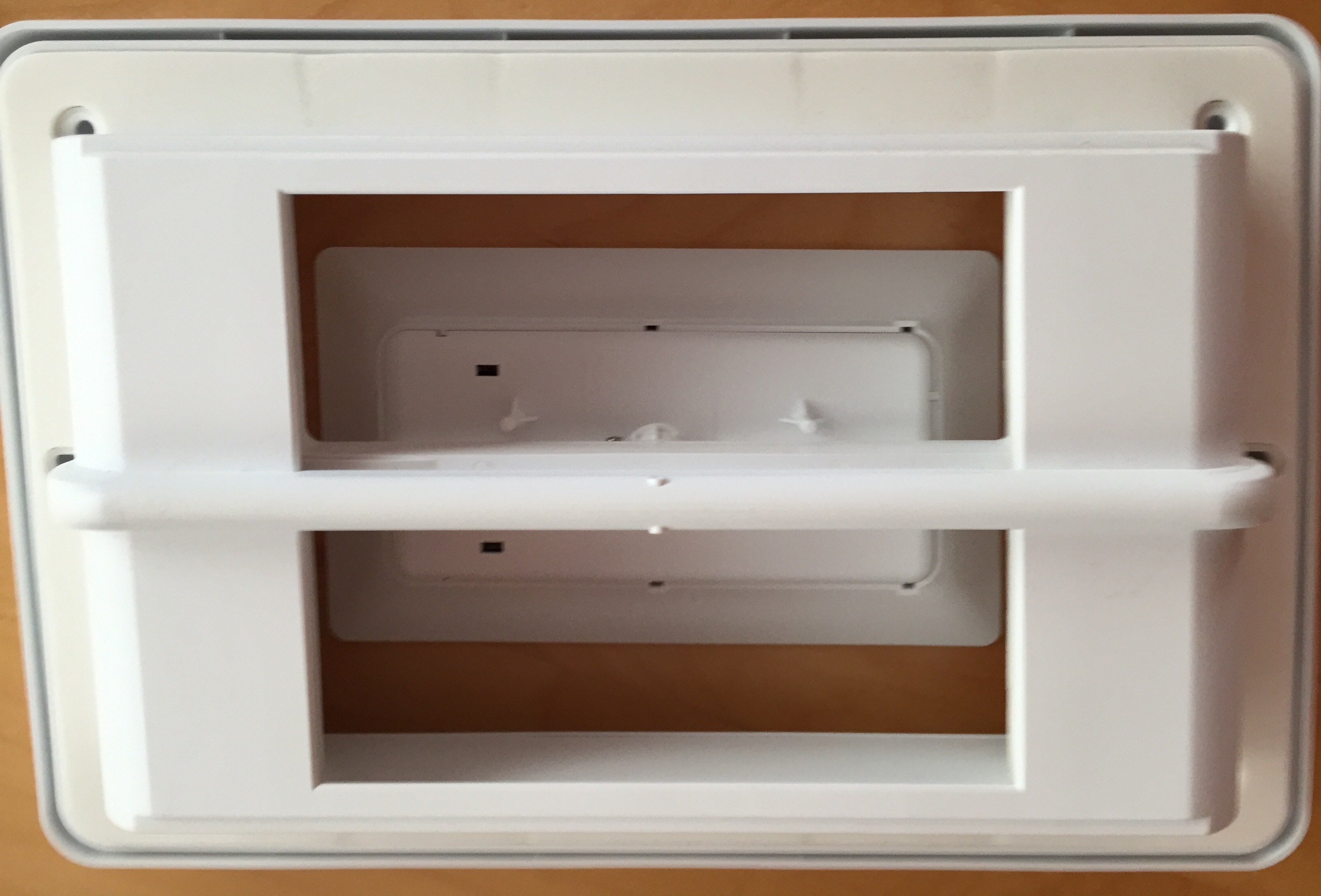

Setup went well with my vents but was a little pain. I had to mod my vents because the age of my house after that all the vents popped right in. I wasn’t able to install one vent because the opening is all messed up, new weekend project I guess. (Photo below) Now as I spoke about above the nest with ecovent has limitations. When the HVAC runs all the rooms get to the temps I set however when my sunroom gets cold it won’t tell the nest to run just to heat up that room (photo below) I have to wait for the nest located in my hallway to drop below the target temp. The support has been awesome and respond to my questions within hours. They are still working on the app and system so I hope they might improve this because I don’t want to switch to the Sensi thermostat. I had one vent give me issues during the installation. I couldn’t get it connected and they had help me get that fixed within the hour via email support. Now I’m waiting for them to give me access to a portal that will allow me to see all the vent and sensor data and I am still pressing them to give me access to their API. I have plans to use my ST motion sensors to tell ecovent if a room is occupied or not and also use sensor data to bring into SmartThings to control my fans or my humidifiers.
