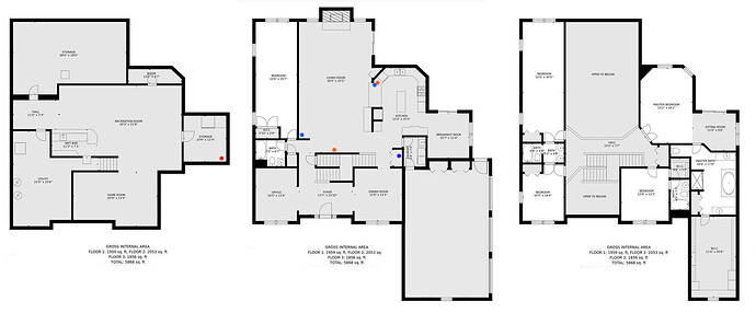

Here is the floor plan to my house. The red dot is where the main hub used to be and the orange dots are where the sub hubs were. The blue dot is where the main hub is currently and the teal dots are where the sub hubs are. My computer is in the office and there are other computers in most of the bedrooms. The house is standard construction… basement has poured concrete walls, the upper floors have stud and drywall construction. The exterior is a combo of bricks and vinyl siding. Asphalt shingle roof.
This morning I took a new laptop around and did wifi speed tests (by Ookla) in various locations. The results were pretty good. I was getting between 150-250Mbps with that laptop in all the bedrooms and major areas of the house including the basement game room. So it seems maybe the system just needed to optimize and maybe relocating and resetting the hubs had something to do with the increase in speeds. Before I moved the Main hub and reset all the hubs everyone was complaining. Now my family is happy.
However, my computer in the office is really slow and only getting 20Mbps right now. This computer is only 5 years old and is using the integrated wifi module on the ASUS ROG STRIX Z270E GAMING motherboard. Also, we have another computer in the basement game room that is only getting about 60Mbps but that computer is probably about 10 years old so I am not too worried about that.
The new laptop in the same position is getting about 170Mbps. So it seems there is an issue with my computer’s wifi capabilities. I am thinking it is hardware related.
