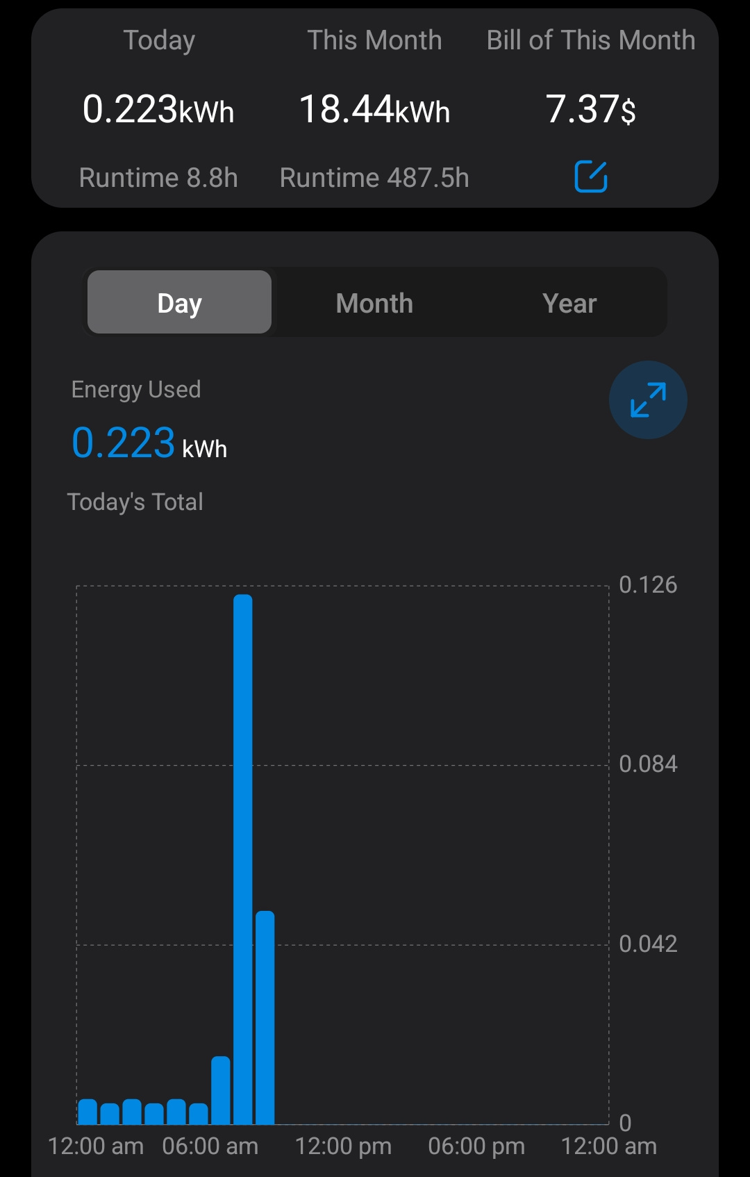

Since my v3 hub updated on the 18th Oct to version 54.00013, my Tapo p110 shows no kWh usage since then.
Within the Tapo app, the kWh metrics seems fine.
Anyone else experiencing this??

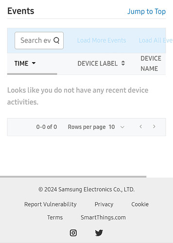

What about the events section?
Switch it on/off to create events.

Have switched it off and on and event are shown.

How many kWh does the Tapo app show?

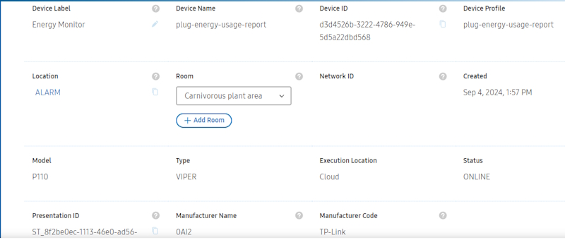

This is from an Eve Energy plug:
And this is from a Tapo P115:
Obviously different devices (Matter vs. VIPER), but the capabilities/attributes for power reporting should be the same.
I had the P115 in use for months and the energy reporting was working. The device profile looks suspicious:
plug-energy-usage-report
Eve Energy:
power-energy-powerConsumption
Time for a bug report…
