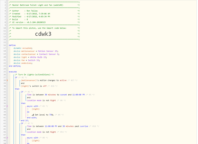

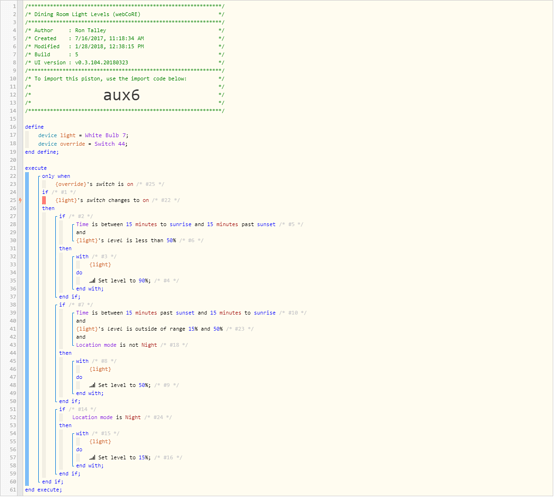

Here’s an example with you can import using the import code at the top of the Piston:
Here’s another example of how flexible webCoRE is. No need for special apps for every scenario. Just need to understand the logic of webCoRE and create your own rules:

Hi there! Thank you for this sample piston. I tried to copy it and simplify for my usecase however the effect I am getting is that when I turn on any dimmer during the time period it will turn on the rest of the lights if they are not on already. I was wondering if there is a way to make this work only for the dimmer switch that was physically actuated without having to create a separate if/then statement for each dimmer within each mode… Attached is my piston based off of yours. Any advice welcome.
dimmer_piston|524x500
Try using the “$currentEventDevice” variable in the ‘with’ lines. That should be the specific device that triggered the piston to run.
You can do it as @orangebucket stated. However, you can easily duplicate blocks by right clicking.
Hi @orangebucket I tried the $current event device variable and still when I turn on a dimmer it will auto turn on any other dimmer that is presently off. Any other ideas?
@rontalley thanks for the suggestion on duplicating, but I have many more dimmers that this would be a tiresome and messy process (and probably would use extra resources to run I would imagine).
Have you tried removing the light and leaving only the current event device on your with block?
Genius! Yes that did the trick, thank you! In my head the two with conditions were linked but seems that adding “light” into it was running in parallel giving the undesired condition.
Very new to webcore but this makes perfect sense now.
Thanks again @MrPancake
Hi guys, I just wanted to do this with the lights in my suite, I wanted to know how the final code looks so I can add on the webcore
What exactly do you want to do? If you manually turn on the light, it will turn on to the last level then dim programmatically to the setting you set in the Piston but there will be a short delay. I posted an example above.
