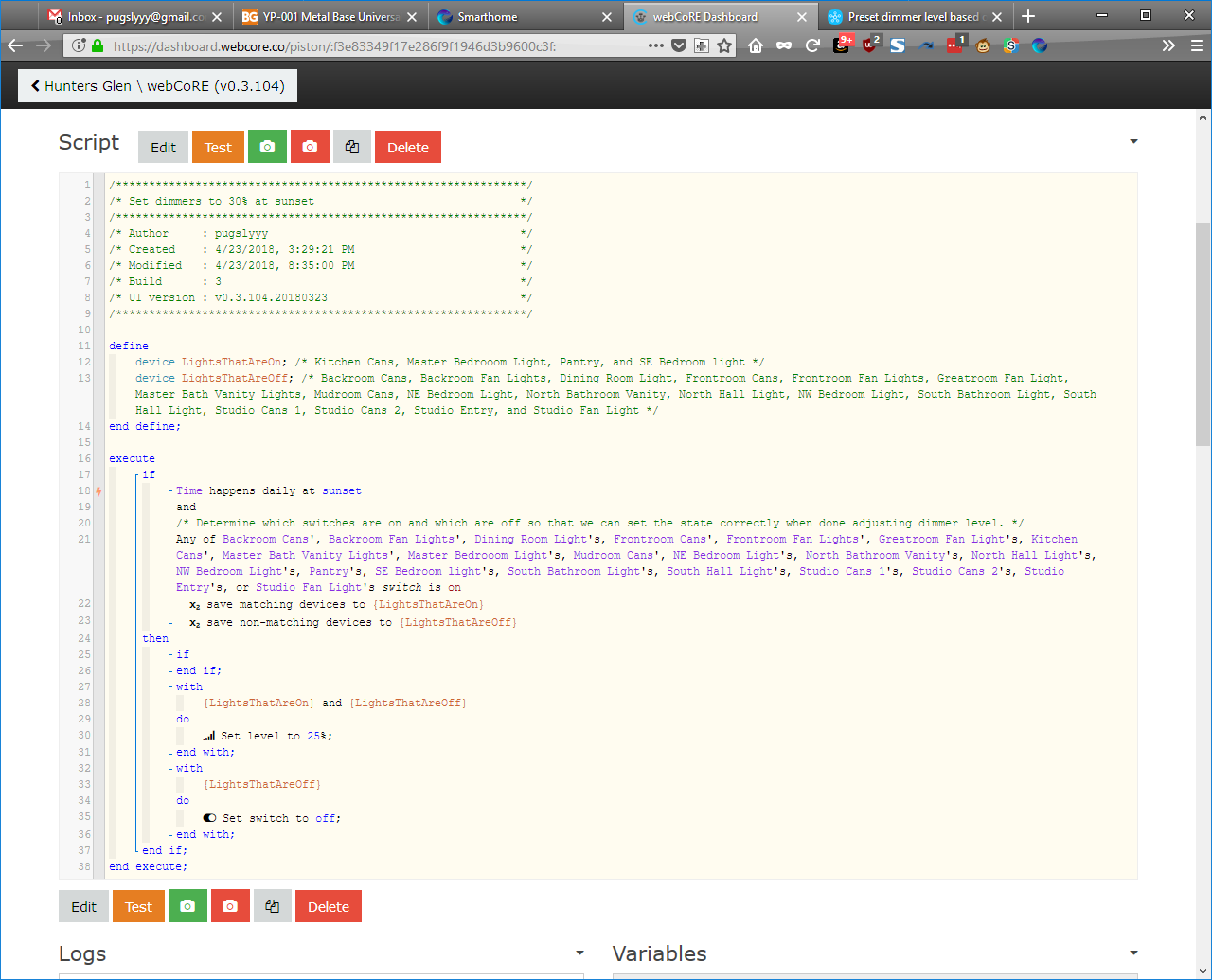

Here’s my approach right now, would like to be able to adjust the dimmer without turning the lights on at the same time but this works.
