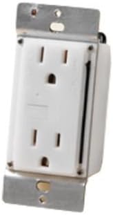

Has anyone tried to add an Intermatic HA05 zwave light module? My hub is just not seeing it and I have rebooted and looked for documentation but so far, not so good. Any help is much appreciated
I have 9 intermatic outlets installed. I had to cycle them on/off/on after the hub was in discovery mode. Plus a few of the outlets required me to move the hub closer to the outlet. I’m not sure what the magic trick is but I also force closed the IOS app and relaunched it for difficult outlets.
Once they were found they work perfectly with the hub in it’s original location.
Cheers,
Scott
I know @Gray has a few of them. With those older intermatic devices I’ve found you have to have the hub very close to them to pair, then they work fine. My Intermatic electrical outlet is probably my most reliable device.
Yeah, I have two of them. I had to put them in a lamp right next to the hub to get them to pair–pretty sure I also had to cycle them a couple of times. But then I moved them to the basement and they’ve been working great (hooked up to turn on with motion detected by a sensor).
The distance was the trick! Thanks a lot everyone.

I have paired 21 things in my house so far. I’m not sure all the different brands/things pair the same. I have all GE (Lowe’s Iris) switches and Intermatic outlets. The GE switches seemed to use the mesh network to pair new devices. So I never had to move the hub as I installed switches. But the Intermatic outlets needed to be close to the hub for the initial pairing.
So I’m wondering if the Intermatic outlets actual use the mesh during pairing. After pairing I could move the hub back to my basement and all the devices work great. I even have 4 exterior Intermatic outlets now for Christmas lights. But to get those to pair (10 ft from a GE switch) I had to bring the hub within 25 ft?

@eschuld No I do not have any of those wall switches. But here are the intermatic wall plugs I have that require the hub (not a GE switch) to be close for the initial pairing:
Scott
Yep, that’s the outlet I have too. Works great…but I had to hook a 50 foot Cat 5 cable up to the hub to get it close enough to pair haha.
