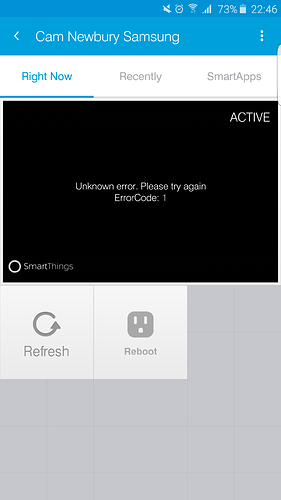

I have a SNH-P6410BN Samsung smart Cam HD in the UK with a ST hub V2 UK.
I recently upgraded the cam via its own dedicated SmarCam app to FW 1.07_151030 and since then I get not video stream from it and an error on the ST app saying " Unknown error. Please try again ErrorCode1".
How can I fix this please ???

Hello all please try now. It shuld be working.
Thanks! It actually worked the first time i tried, however ever since, it keeps showing this error “unable to retrieve livestream URL”… I had this error with a D-Link camera too… Any thoughts what’s wrong here? Thanks!
try to remove the cam from ST then reset the cam to factory by pressing the pin hole button for 15 seconds on the cak of the cam and add the cam to ST again.
Also reduce your resolution to the minimum and try and also try to avoid using 1080p if u can but once the cam is stable use 720p
