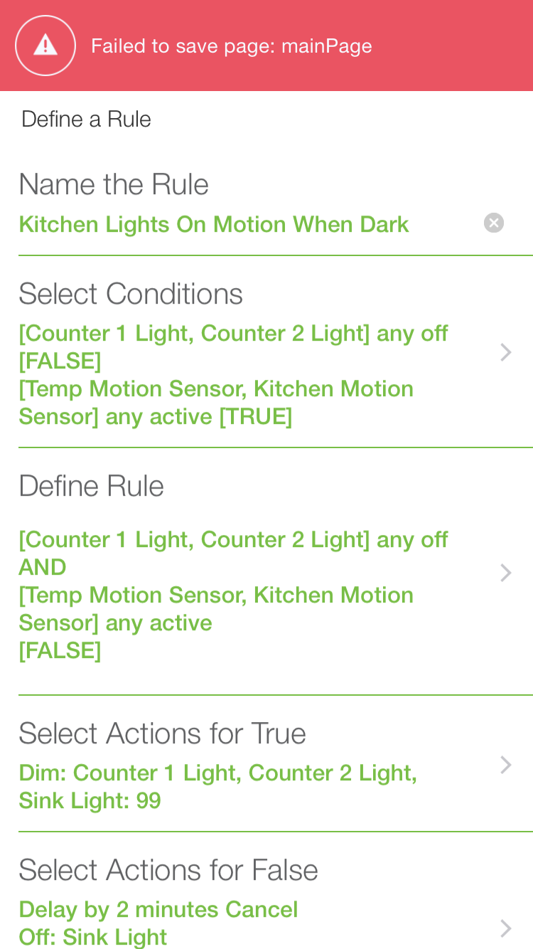

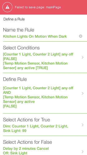

I am now getting where my rules look okay but they don’t do what they are supposed to do. When I go into check on the rule and click done, I get the red banner “Failed to save page: mainPage”. This rule is supposed to turned the lights off after a no motion is detected but it doesn’t do it.
@Jimxenus most likely RuleMachine itself lost its state - try selecting RuleMachine in your SmartApps list and hit done. The same thing happened to me earlier this week and doing so restored RM’s state and made saving individual rules (which access part of RM’s state) work again.
That’s interesting, because hitting Done in Rule Machine does not actually do anything. The updated() method is empty, and that’s what is called.
It must have something to do with the mobile app and it’s state relative to the server state.
