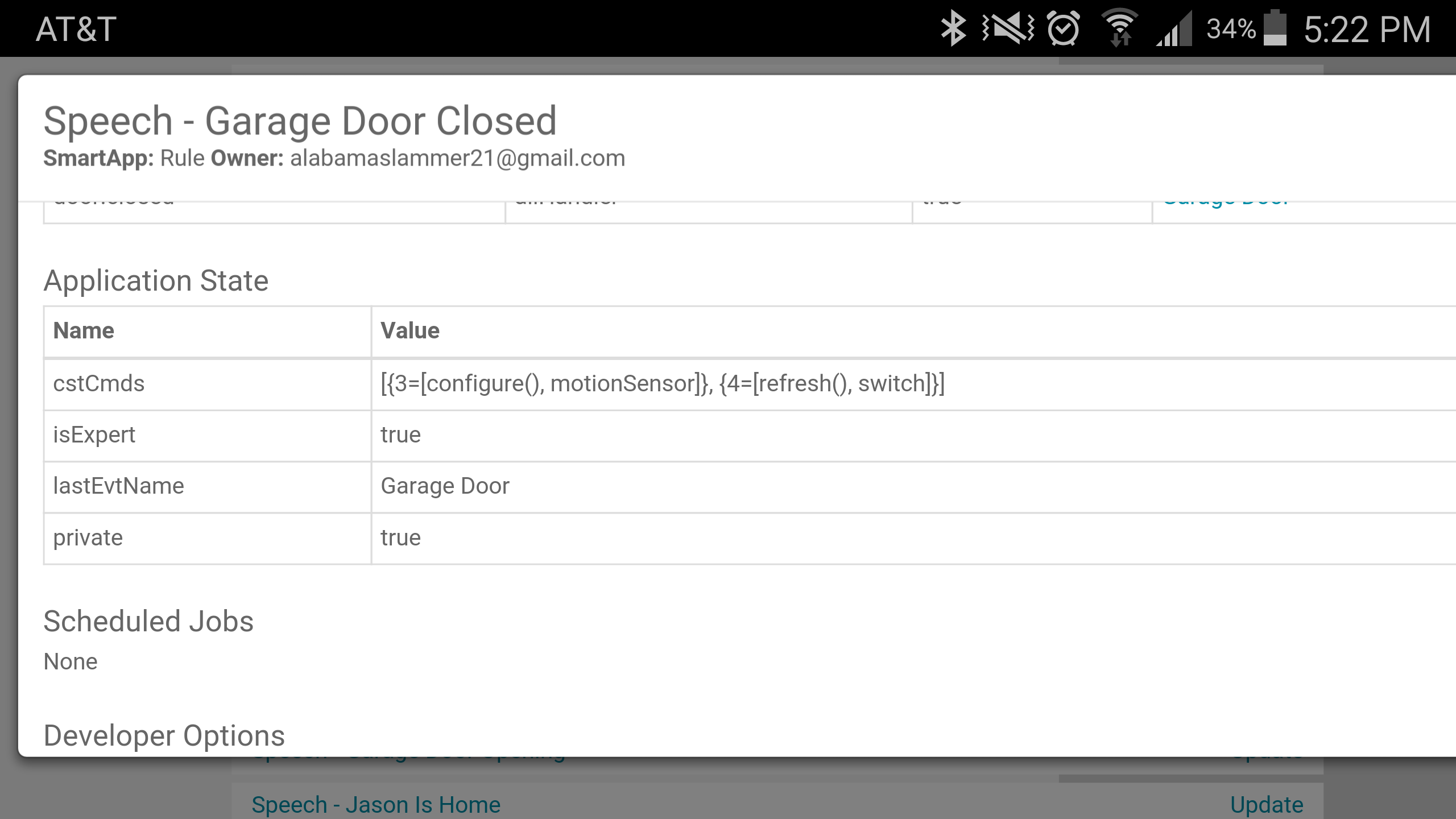

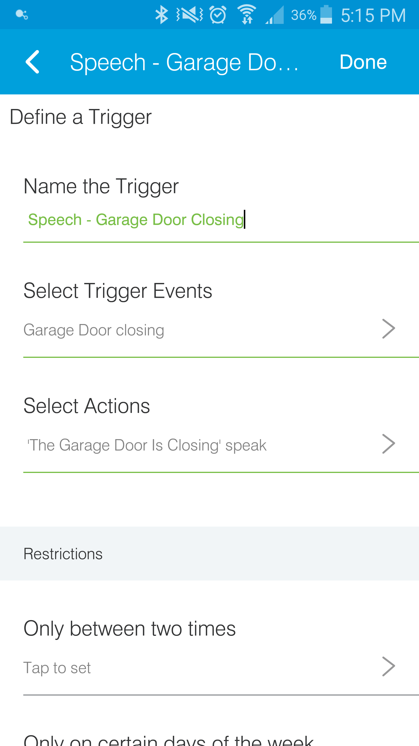

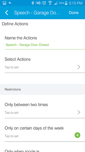

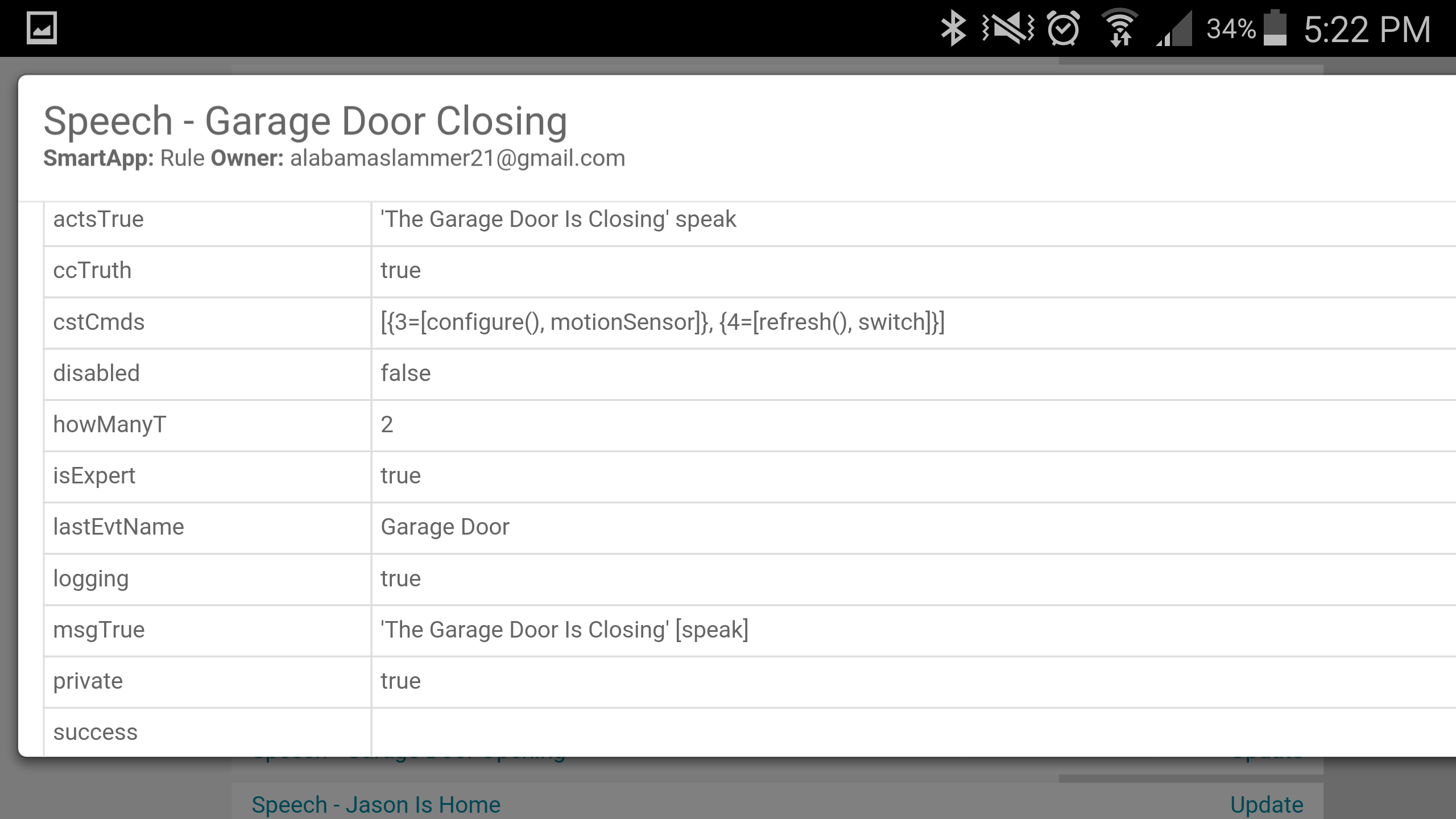

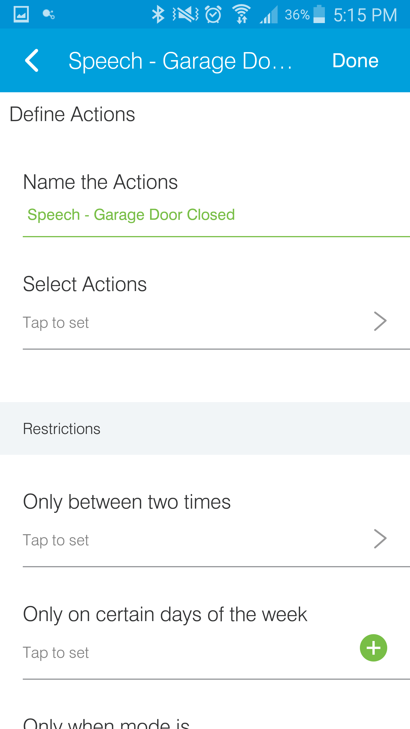

Hereās another lost ruleā¦
The first two are pics are of an identical good rule.
The second two are the destroyed rule.

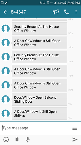

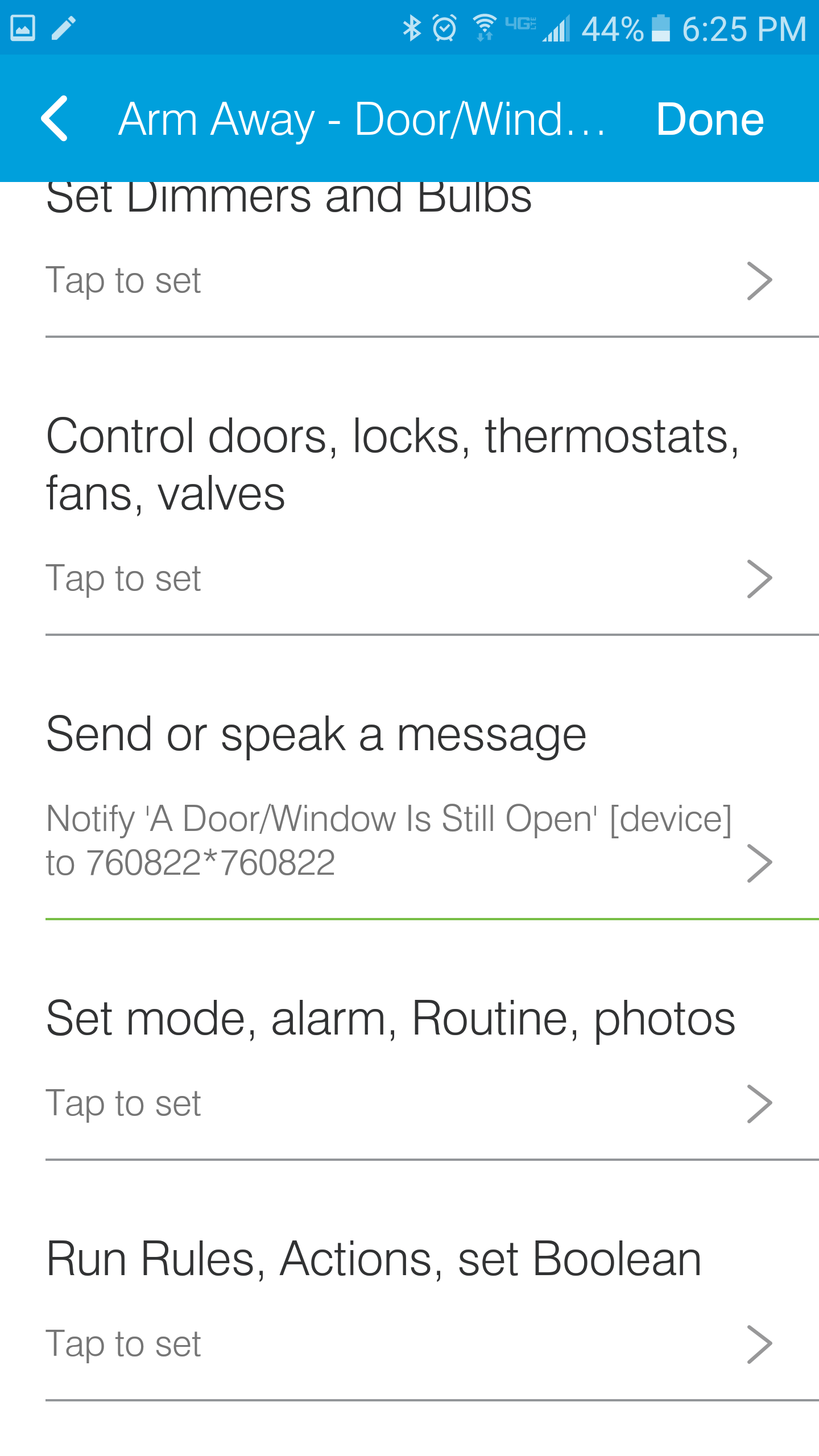

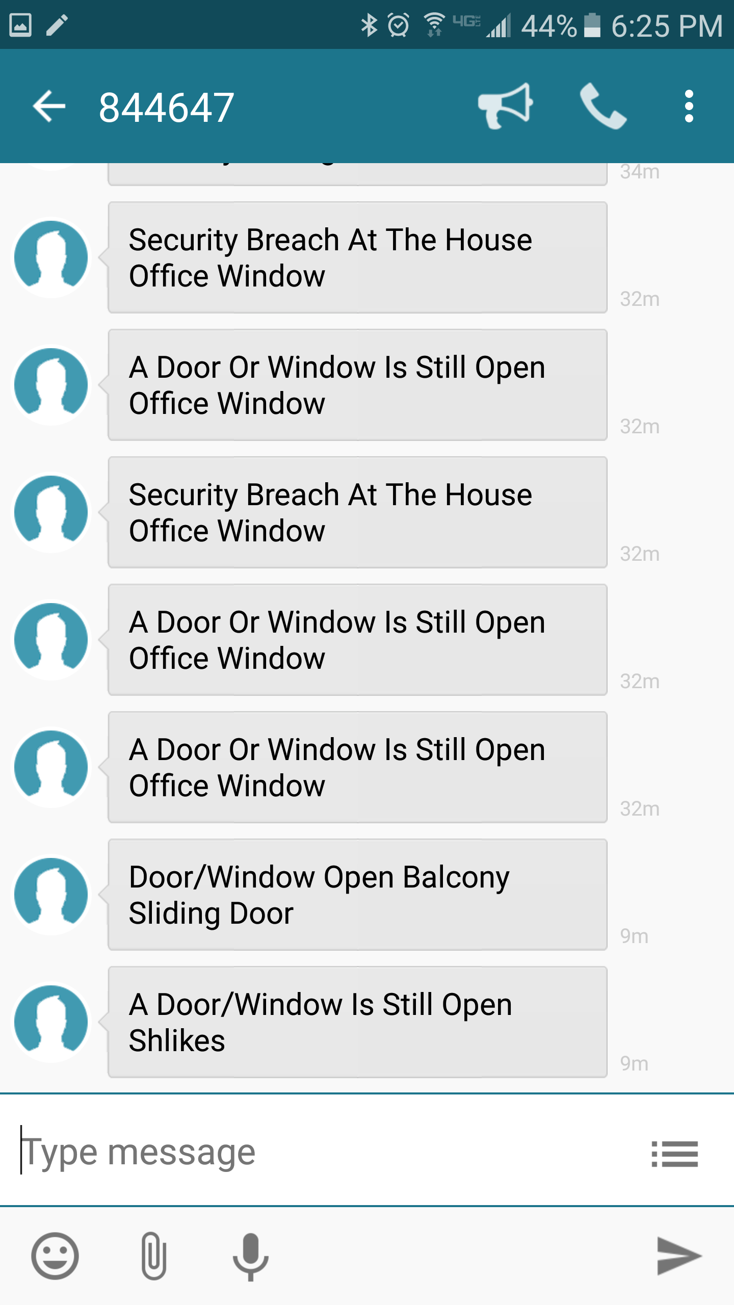

Hey Bruce,

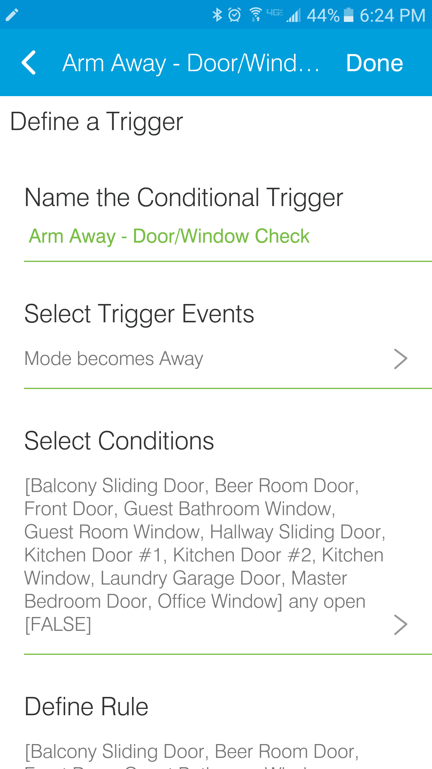

I would like to review a previous topic/issue I am having again. When I create a āRuleā and set it to notify me via text w/device name, I get the device name, which is perfect
When I create a Conditional Trigger and have it send me a text w/device name, it actually sends me the name of my hub and not the device name.
Here is the CT
Here is the text msg, notice the bottom one, itās the CT and it shows my hub name. The one above it is the Rule and it shows the device name
What am I missing?
Rick
Yea, I know. Hereās the deal. The device that gets sent has to send an event to the Rule so the Rule can grab its name to send to you. In a Rule, that works as expected. In a Conditional Trigger it doesnāt work because the rule isnāt even listening to the devices in its Conditions. It looks at them when itās triggered.
Iām not sure what, if anything to do about this. I know exactly what youāre dealing with because I had the same problem. So I ended up sort of redesigning how I did things so that there was a Rule where the device could be captured, and Triggers or Conditional Triggers that messed with that Ruleās private Boolean. It isnāt pretty.
Iāll continue to think about this problem, but it doesnāt have immediately obvious solutions.

Well that makes about 5 or 6 big ones theyāre working onā¦
I opened a ticket with support on this issue as well (207997)
It isnāt an RM-only issue. Iām losing simulated switches because they donāt know their off/on state.

I opened case: 207655 with Support and they replied acknowledging the issue (headless/zombie Rules) and are working on a fix. Advised Iāll be contacted once resolved.
