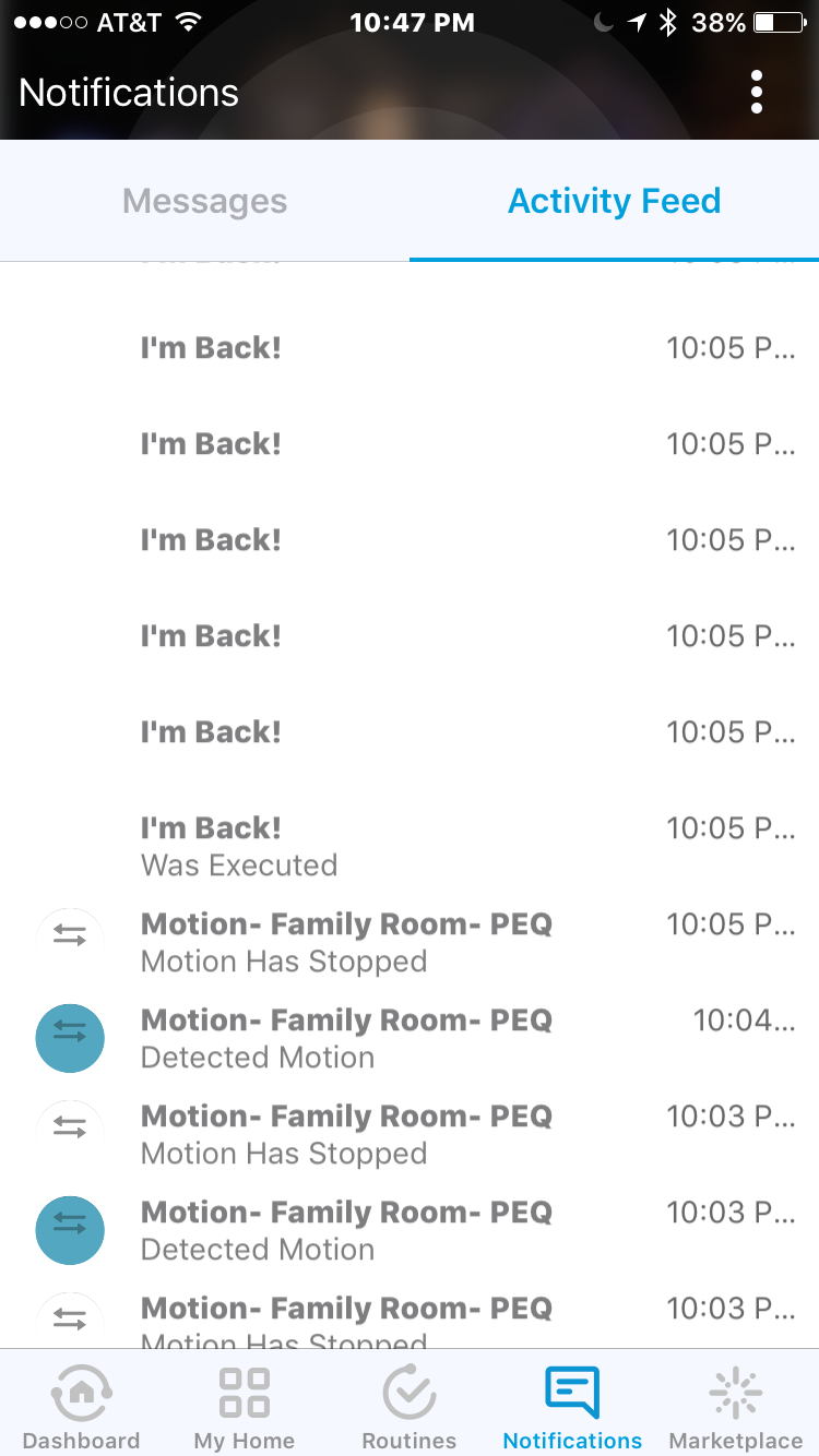

At 10:05pm EST last night, my I’m back routine was executed. What’s alarming about this? There was no trigger for this action listed in my logs. It just happened in its own. Attached is a screenshot of my logs. I checked my presence sensors and none of them are listed as having returned at that time when I looked at their logs. In fact, all of them were listed at home the entire time.
A light coming on randomly is one thing. A routine executing is way worse, especially when locks and security modes are linked to them.
Anyone have any ideas on this one? I’ve already submitted a ticket, but I wanted to hear from the community. This has never happened before. In fact, I’ve never even had a light come on “for no reason.” If anything, I’ll have something not execute.

Support got back to me and they are perplexed on this one. They confirmed the presence did not trigger this event. They said they would pass this along to others on Monday to determine the cause.
