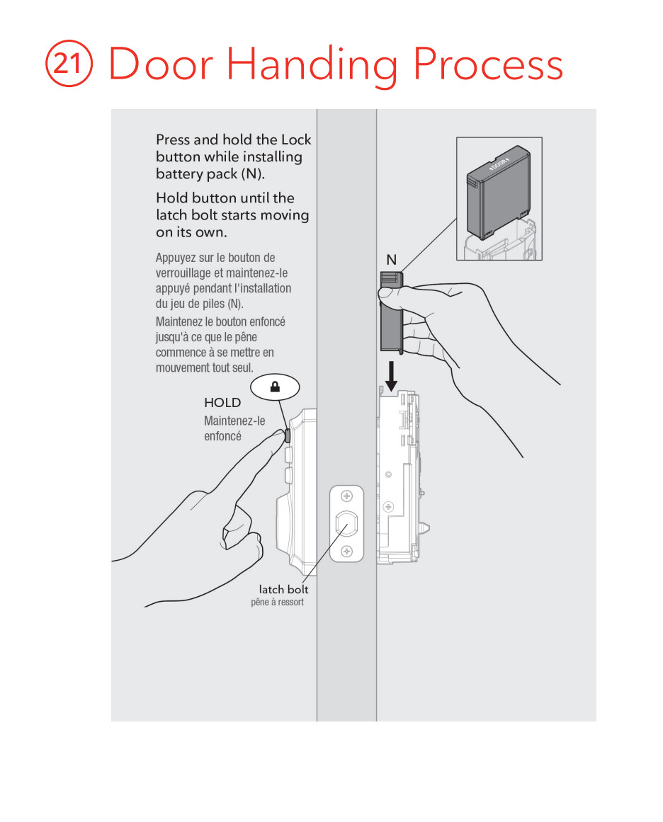

  • Follow STEP 21-24 of [REF 3] to re-calibrate the lock and program your PIN

  7. Complete the handing procedure after the lock has been reset to restore the lock to default:
  • Make sure that the deadbolt is in the unlocked position.
  • Wake the screen on the touchpad, enter the master code and press #, enter 3, then # to enter Advance Lock Settings.
  • Enter 5, then # and then # again to Hand the lock in the correct direction. Make sure that the deadbolt is in the unlocked position when handing the lock.
