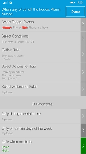

RM scenario I can’t seem to make it work
I have two phones act as presence devices. If any of the phone leave the home; 30 minutes after that, if the home is not arm (Stay or Away). Change it to Arm (Stay). If the mode is Arm (Away), just ignore it. Please give advice. Thanks.
It still kicked in 30 minutes afterward even the mode is already Arm (Away).

My thought is to use RM to set the mode to Arm (Stay) 30 minutes after either of us left the house.
The Routine – Goodbye! will set to Arm (Away) in 10 minutes when both of us left. This is working fine.
For some reason. My RM in the initial post still kicks in after 30 minutes we left the house. I would think the “Only when mode is” Home and Night will prevent the rule to kick on. Obviously I make a mistake some where.

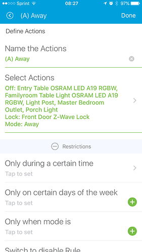

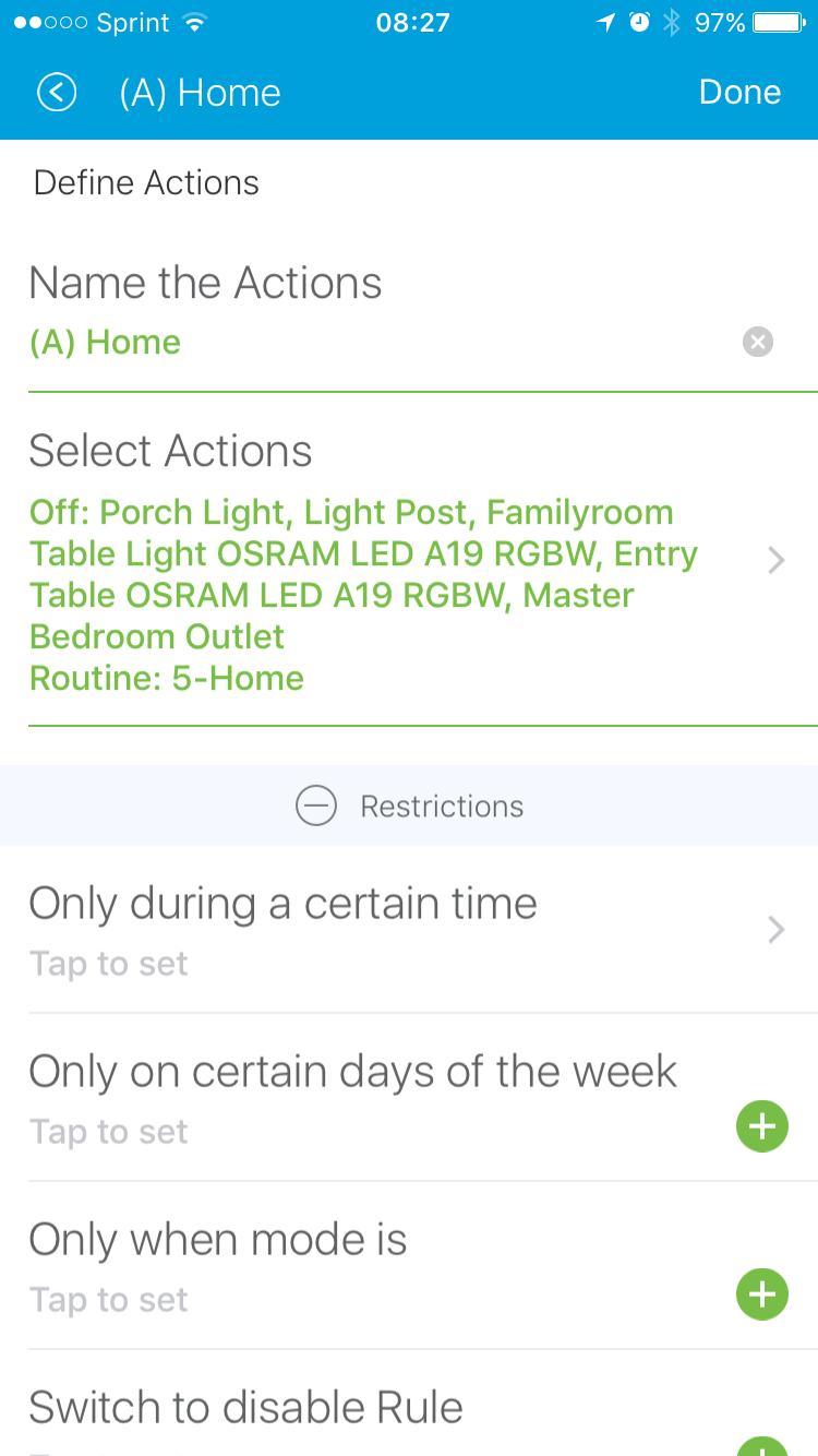

In RM I have several actions that I have created because I use the same actions for multiple conditional triggers or rules. Furthermore I always label my RM commands with either (CT) (A) (T) or ® to identify what type the command is.

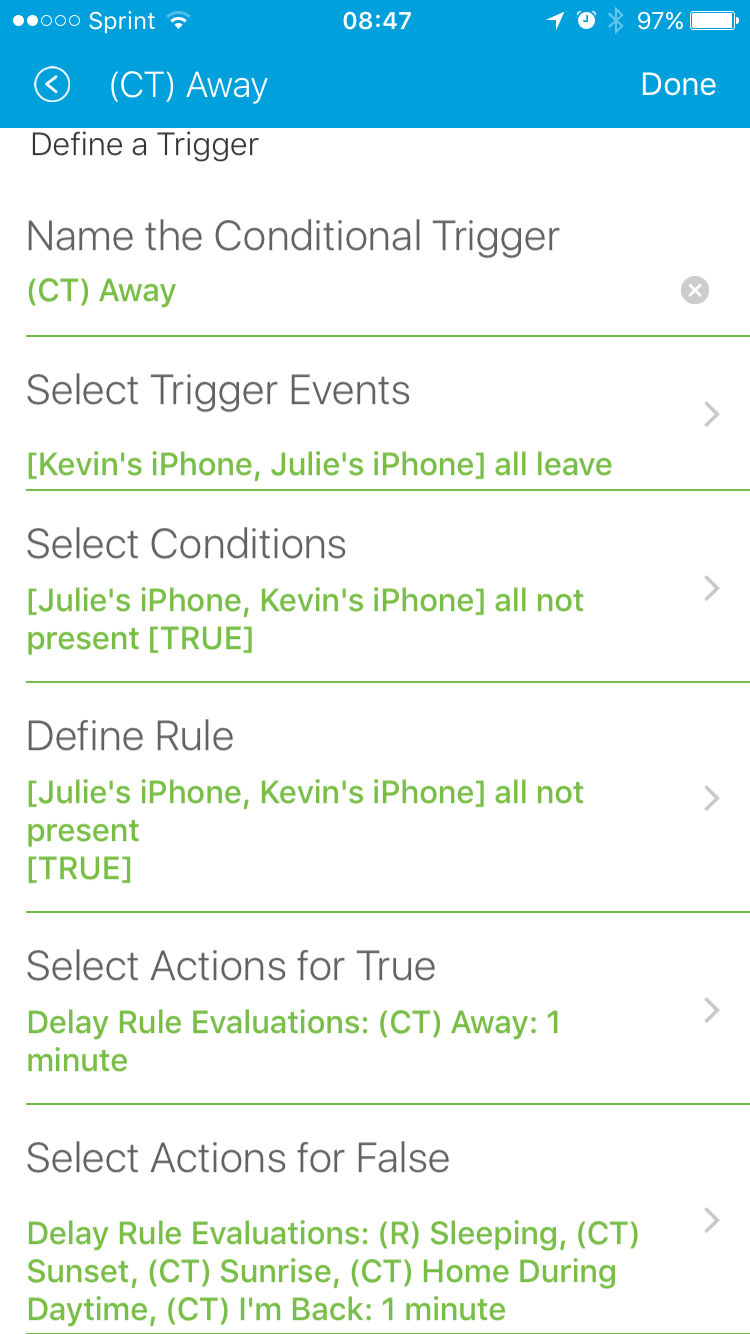

For each one of these routines you need to have an action & then the command to activate that action. I like to use (CT) but you can use (CT) or ® in rule machine. It needs to mimic your routine parameters exactly ( Trigger, action, condition) & you will need to have a false parameter to counter the action. Then you can set rule machine to evaluate either your (CT) or ® with a delay. And if your routines didn’t fire the RM will fire after the delay.
For example using the away parameter in rule machine.
Trigger= everyone’s left
Condition=everyone’s away system is armed away.
Action true= Evaluate after delay all lights off, all doors lock, system armed away.
Action false= Evaluate after delay, stay rule & night rule.

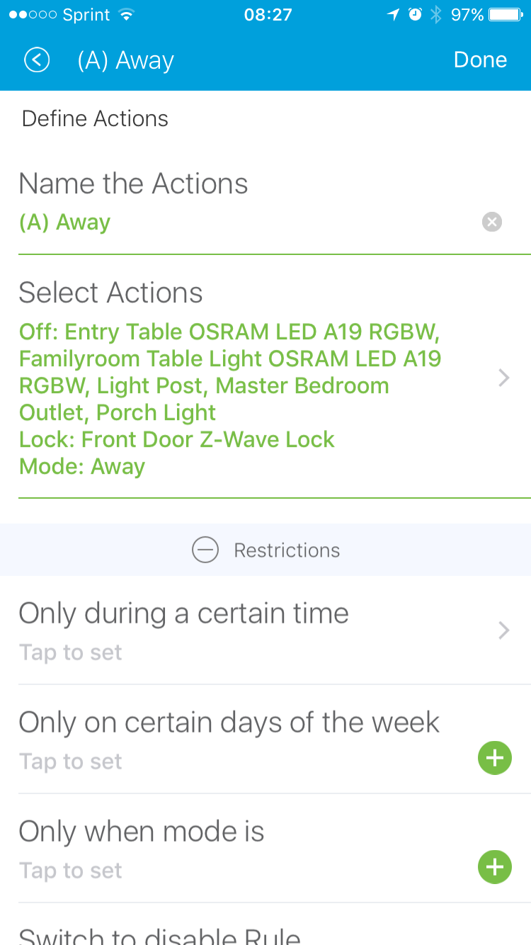

what you can do is (see below) & assuming you have return rules & so on.
Create a Conditional Trigger
Trigger event- using something constant like time of day, door sensor opening & closing & so on.
Conditions- select the trigger event above (what ever you picked) & add when anyone is present.
Then select your true action ( Away parameters)
False action would be your stay parameters.
If you look below my house everyone is always gone by 7am so I created a trigger using 7am as my event, pay no attention to the evaluate portion because this rule is a verifying rule to make sure my routine fired after 1min. But the parameters would be similar to yours.
