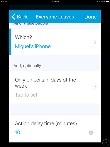

Forgive me, I’m confused. Did you try to do this in a routine, or with the smartlighting feature? You mentioned both. These work differently, so it does make a difference.
If you could post a screenshot of what you have set up, we could help you better.
Also note that “after sunset” and “at sunset” are two different conditions. Again, you mentioned both. That’s why the screenshot would help.
Also, are you using a mode for “away”?

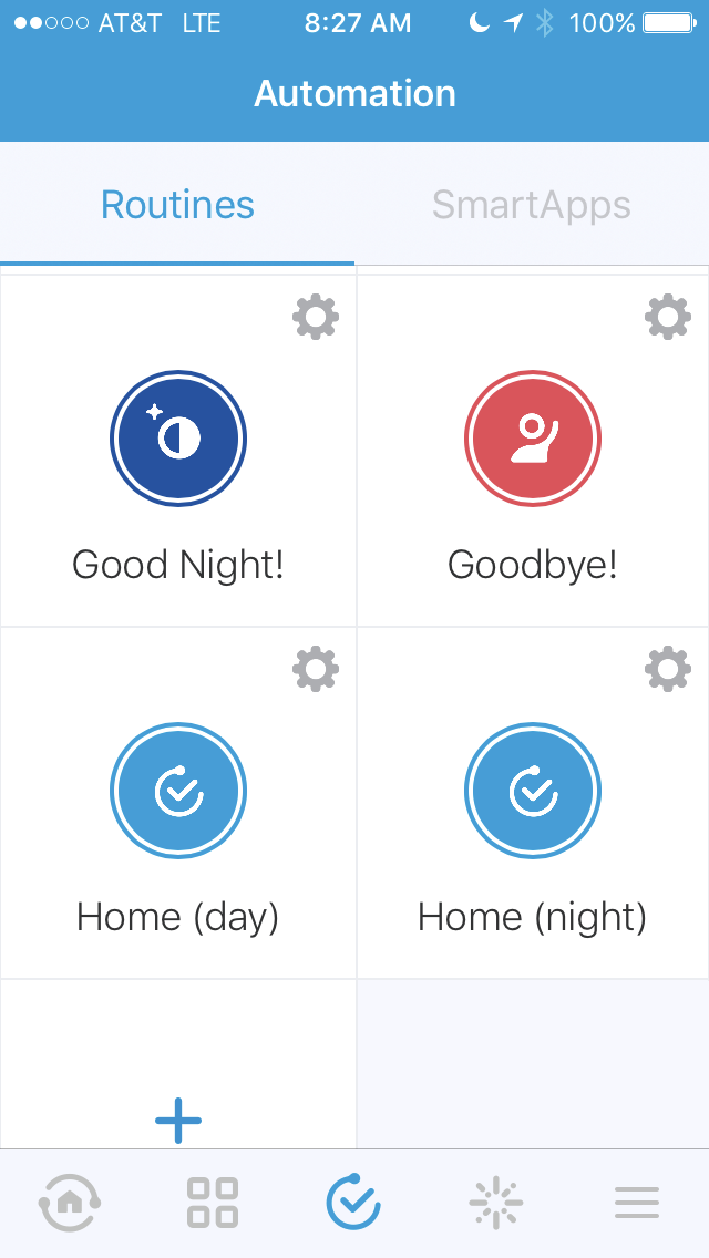

Routines

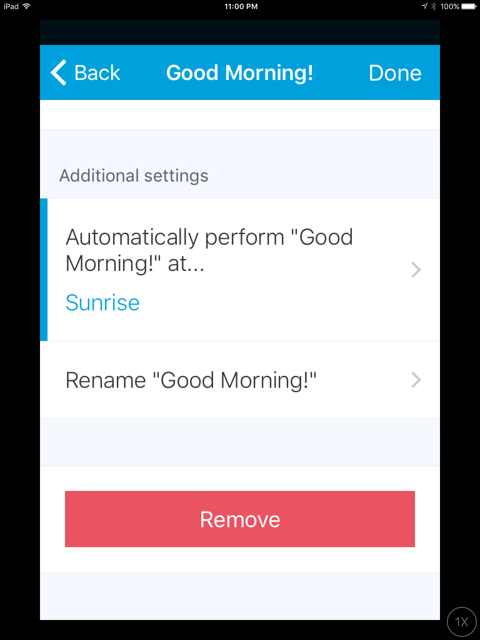

Good Morning!
Change mode to ‘Home’
Automatically perform “Good Morning!” at Sunrise
Advanced Options: Don’t automatically do this if I am in one of these modes ‘Away’
Goodbye!
Turns off: ALL Harmony activities, desk lamp, Living room sonos
Change mode to ‘Away’
Automatically perform “Goodbye!” when Everyone leaves (myself only)
I’m Back!
Automatically perform “I’m Back!” when Someone Arrives (myself only)
Good Night!
Turns off: Desk lamp, Living Room Sonos, Harmony activities
Change mode to ‘Night’
(I toggle this at night before going to sleep.)

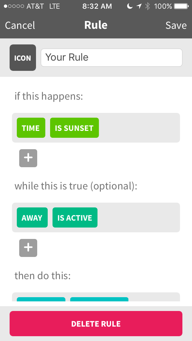

To do what you want in smart rules. Let ST handle the presence of everyone and switch to away mode (or whatever mode you prefer) when they are all gone.
SmartRules is excellent and very easy to use. I found it Well worth the $10 in the App Store. It’s basically “if A while B, then C.” so it adds one more level of complexity, but it’s a very useful level.
Core is much more powerful, but also much more complex to set up and use. Quite a few people use both just because SmartRules is nice for the simpler stuff. And many people find SmartRules is all they need.
