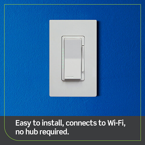

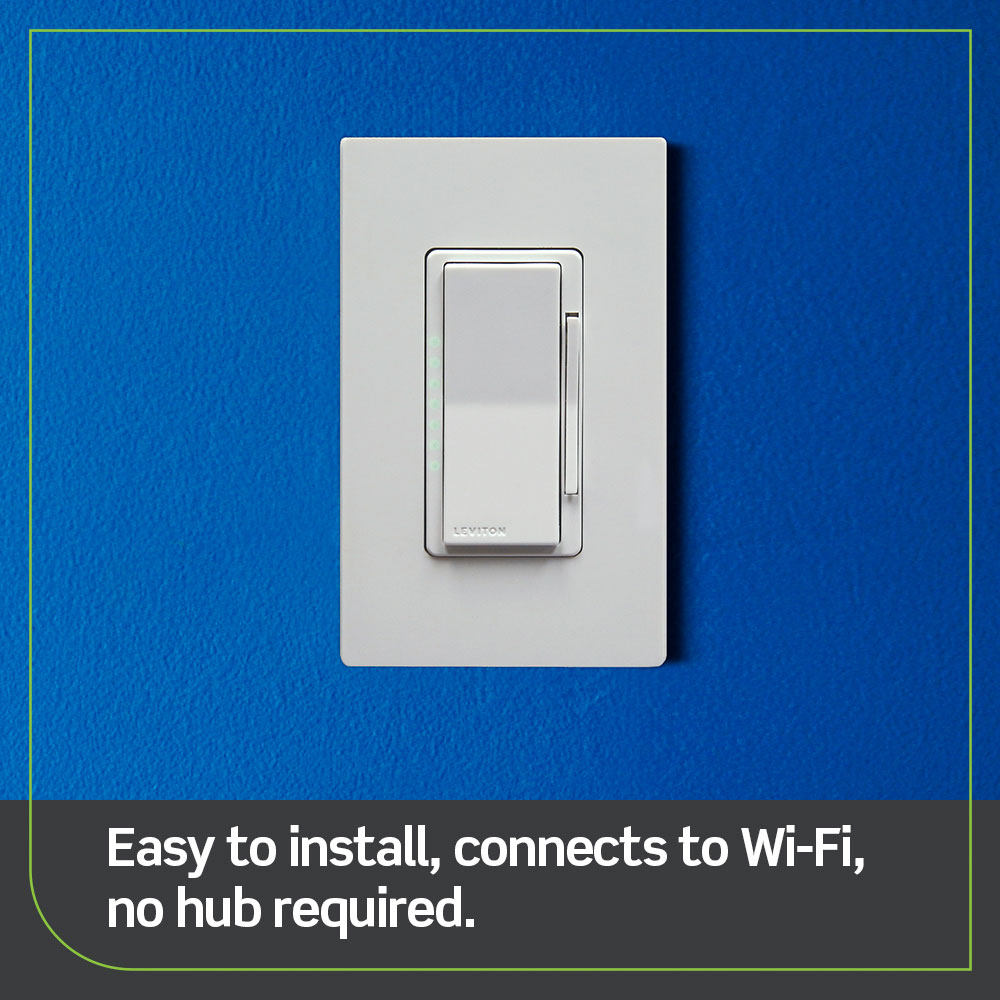

If it was me (and I’m surprised Leviton didn’t suggest this), and you didn’t want to go with Lutron, i’d consider just upgrading everything to the current Leviton Wi-Fi versions.
These don’t require a hub, have a nice app, work well with the various smart speakers, and would just be a one to one swap for the existing devices.
Here’s the scene controller:
And here’s the dimmer switch, which does work with LEDs as well as incandescents.
They also have a dimmer switch that can support a higher load if you need that.
These aren’t the least expensive devices you can get for this use case, but they are well-built, reliable, work with a number of different systems or as standalones, and would basically just be a technology update to what’s existing there now.
If you have a contractor’s license, you should be able to get them through one of their contractor channels at a lower price.
Again, no hub required. And you don’t need smartthings, although some of the models do also work with the SmartThings system if for some reason that is a requirement.
(Note that Leviton makes devices on a number of different protocols that look very similar, what I am suggesting is the “Decora smart WiFi“ line which is Wi-Fi, not zwave, zigbee, or Bluetooth. So make sure you are looking at the right model each time.)
