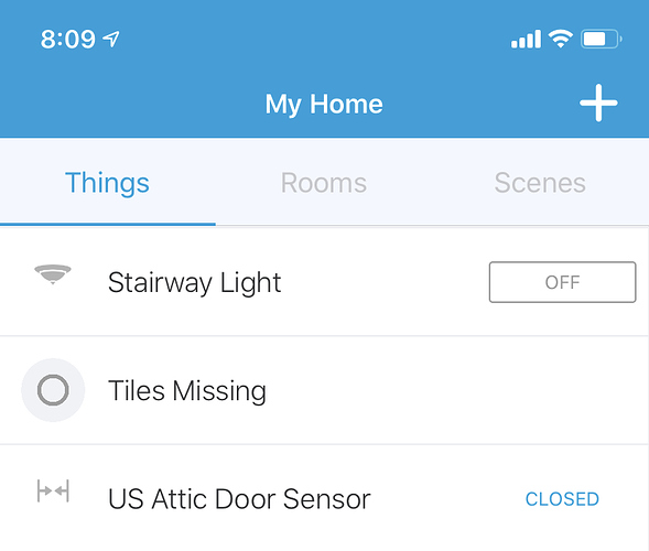

@krlaframboise So I had a weird thing just happen with my child device and I use the Classic app exclusively. I have my main device named Zooz MultiRelay and my child device named Fireplace. The master device is just fine however when I opened up the app today I noticed that my child device was missing. After scrolling through the list I found it further down with the title “Tile Missing”

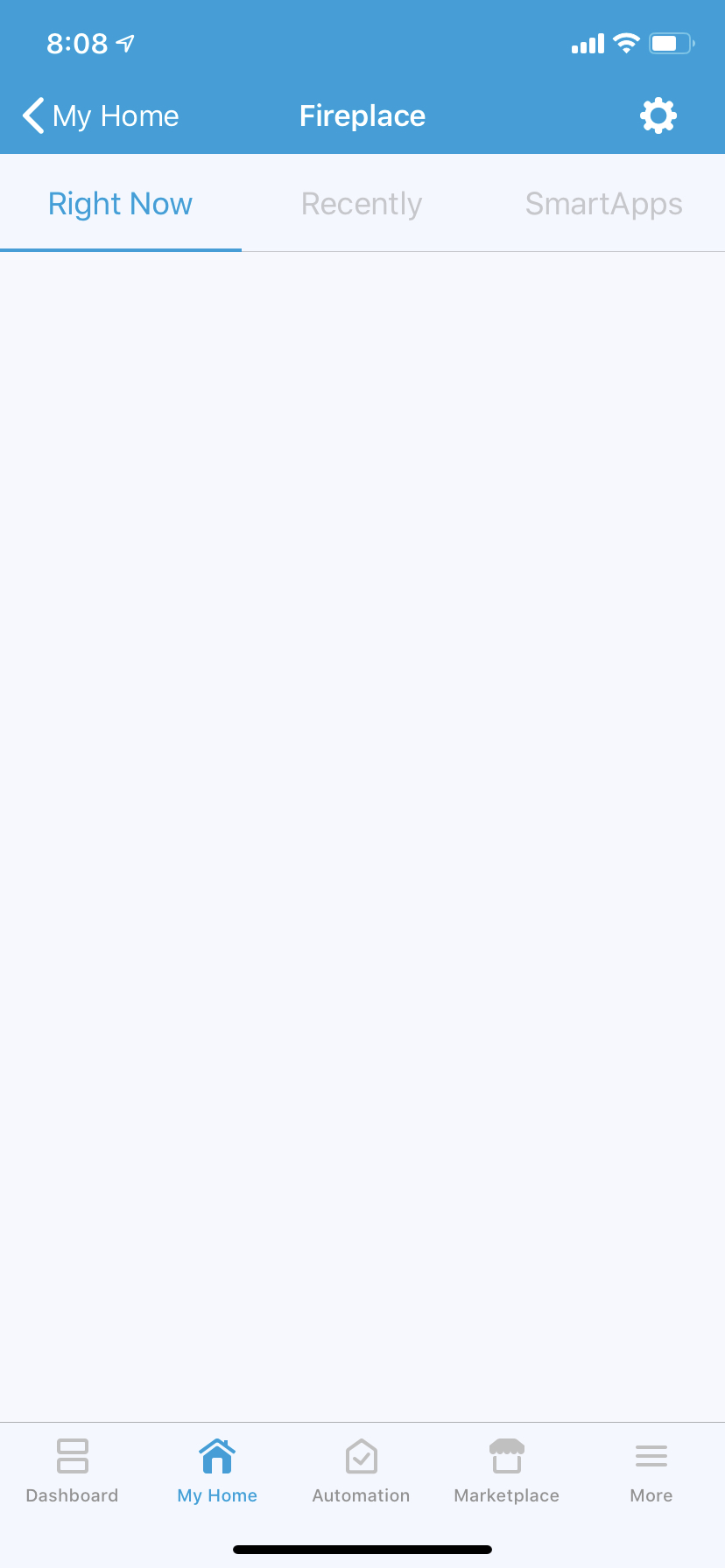

When I click on that device I get a blank page, but the title of the page says Fireplace as it should and not Tile Missing.
I can still control the device through the Master device and turn on just the 1 relay and I can also still control it through Google Assistant, but can’t through the child device directly.

Nevermind, I figured it out and seems like it’s a similar issue to @Automated_House. I went into IDE and found that my child device had switched the DTH to “placeholder.” I changed it back to the default Child Switch and all is back to normal.
I’m not sure why it would have suddenly changed. My only guess is that it happened when I moved the device to a room.
