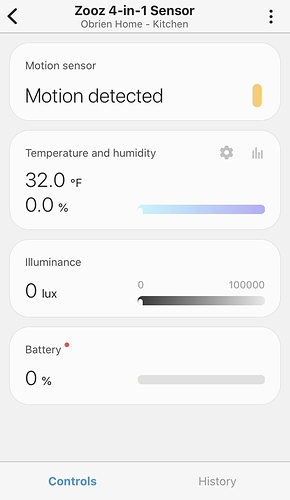

Hi. I just configured your device handler. Thanks for the solid efforts behind it. It looks like my sensor is only accurately indicating motion, but none of the other parameters. I have attached a pic of my device display. Do you have any ideas? Thanks.
