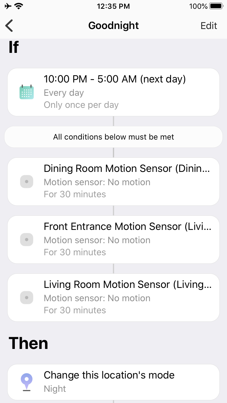

The new app automation engine is tricky to setup (and sometimes buggy). I think you’re trying to replicate the “When things quiet down” feature of the Classic app in the new app using the automation. Here is an example of how to replicate that feature in the new app using automations.
Ok, I’ve duplicated your example. I’ll try it tonight.
