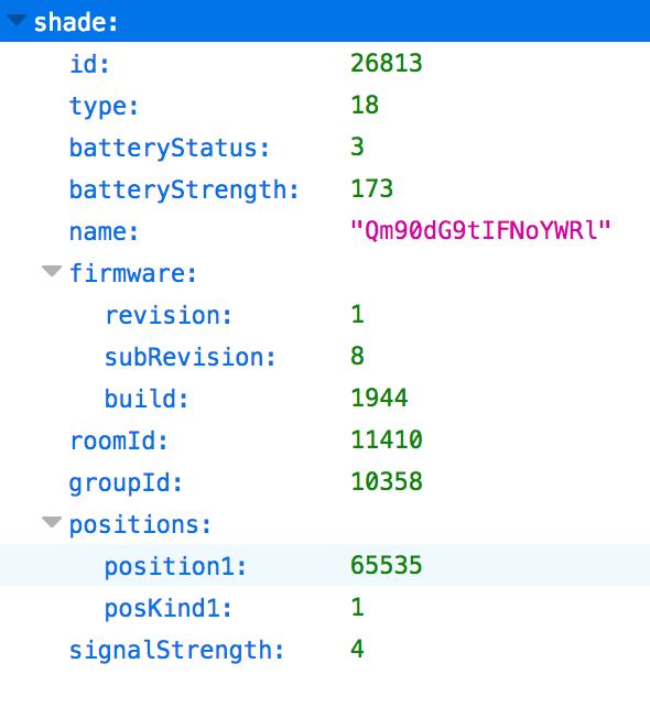

@johnvey, shade status is working with the ST device. I installed mitmproxy and configured my iPhone to use the proxy. When I open and close the shades with the PowerView app I see the following entry displayed in the terminal.
192.168.1.160:55680: PUT http://192.168.1.182/api/shades/26813
<< 200 OK 248b
Entering that URL in a browser returns the following info…
@sgonsalves thanks for setting up mitm. Can you post the raw request and response as well? Given that the URL looks to be the same, I suspect that the PUT request body is what has changed.
Not sure if I’m doing this right, but when I click raw and download the file from mitmweb interface. I get this for the request ->
{“shade”:{“id”:26813,“positions”:{“position1”:61460,“posKind1”:1}}}
and this for the response ->
{“shade”:{“id”:26813,“type”:18,“batteryStatus”:3,“batteryStrength”:173,“name”:“Qm90dG9tIFNoYWRl”,“firmware”:{“revision”:1,“subRevision”:8,“build”:1944},“roomId”:11410,“groupId”:10358,“positions”:{“position1”:61460,“posKind1”:1},“signalStrength”:4}}
Yes, that’s exactly what is needed. There isn’t any change to the API, but I have a theory that the gen 2 hub is much more sensitive to some input values.
@sgonsalves I’ve updated the repo with a possible fix:
  1. update your shade device handler (via the Smartthings IDE)
  2. goto your shade device on your ST app
  3. click the gear icon to edit the config
  4. save it (you don’t have to change anything, you just need to cause the app to trigger the install() method)
Please let me know if this resolves anything.
Well your theory was bang on :grin: Works like a charm, thank you!
