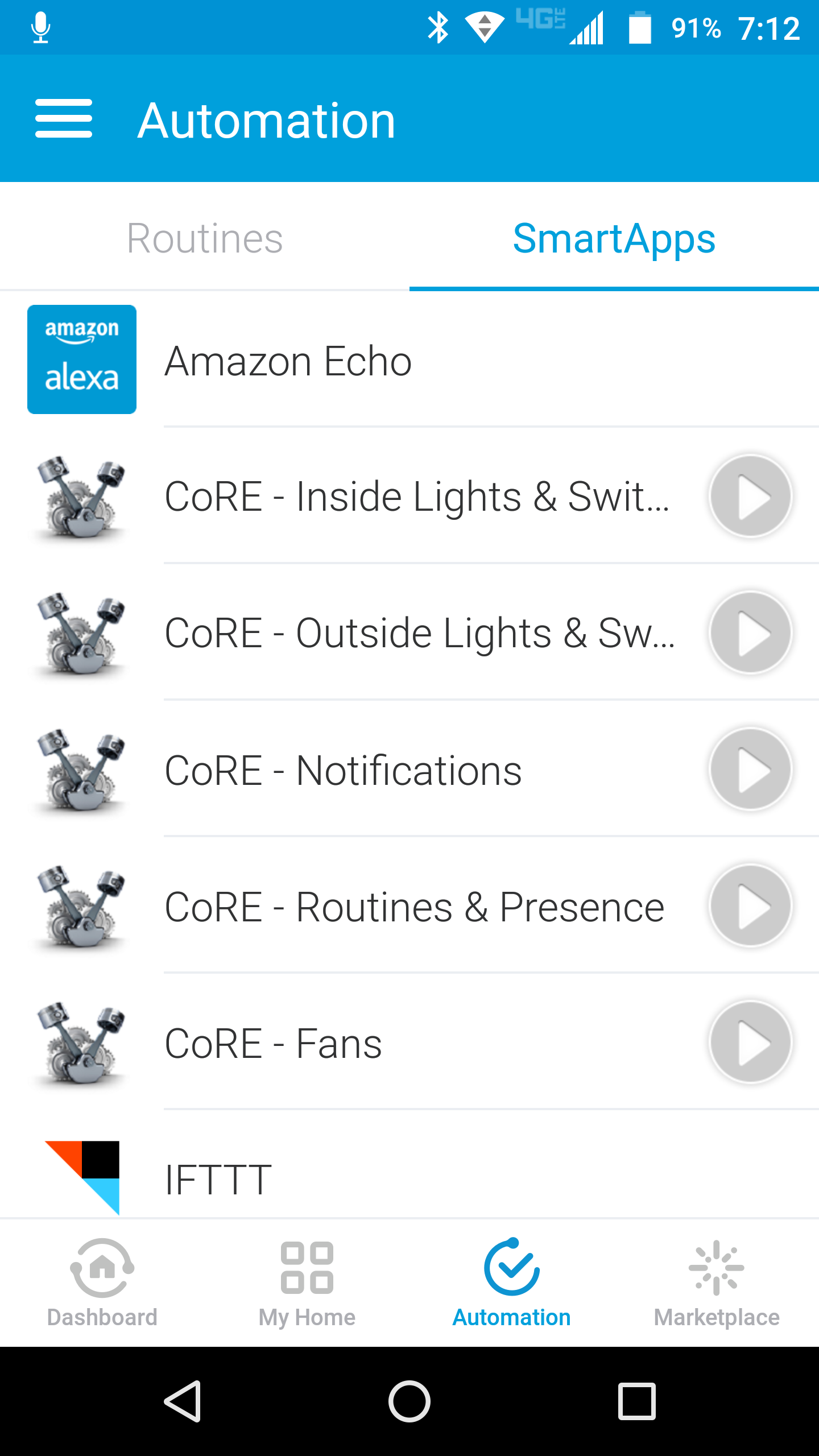

Ended up with 5 instances, working great. It’s back to being a snappy, responsive app with quick loading dashboard pages. My biggest instance is the Inside Lights one with 16 pistons.

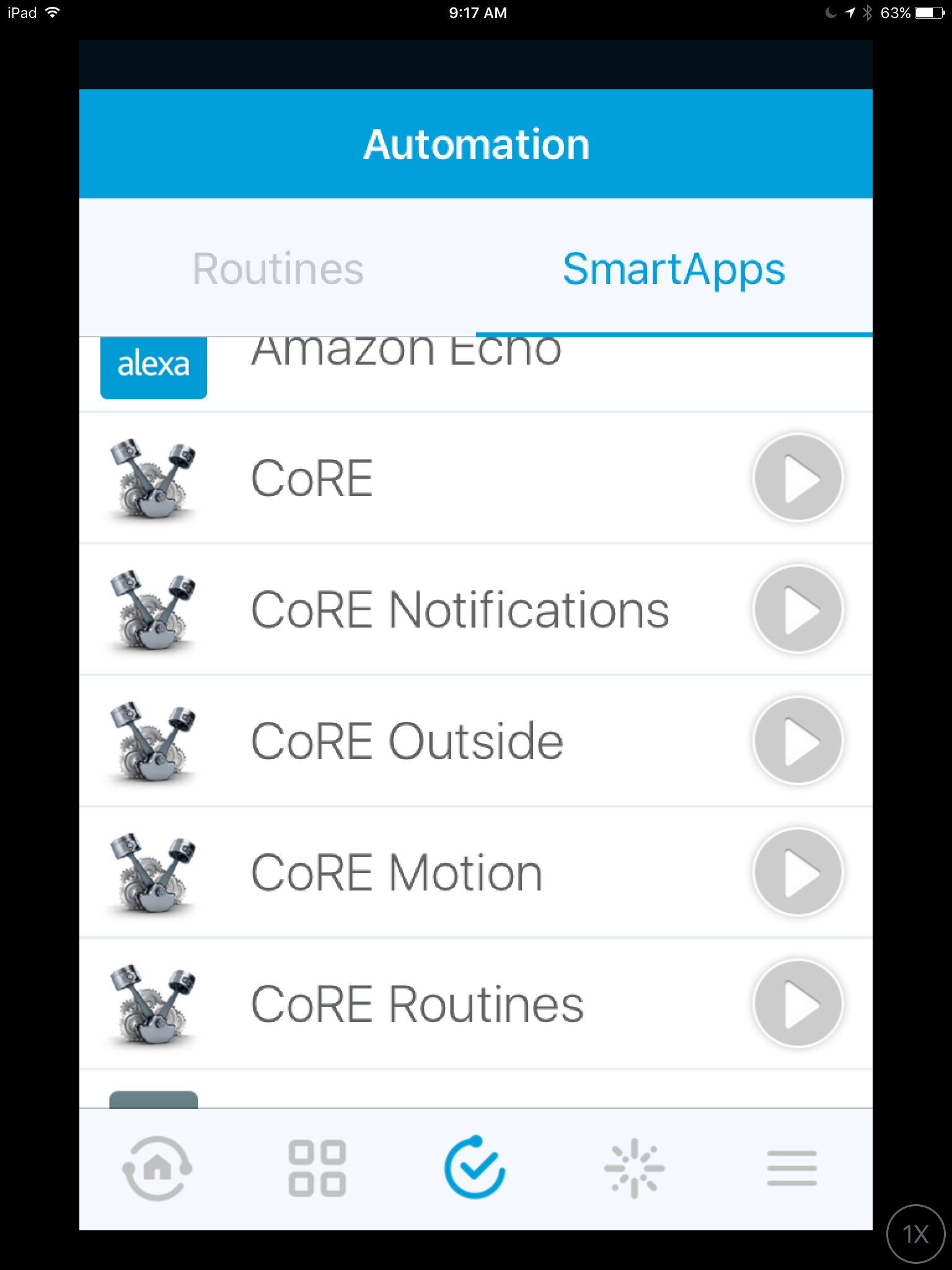

Did you know that you can access a CoRE piston from a device’s SmartApps page? Go to a device that is used in a piston, select the SmartApps page on the top selection bar and tap that piston. This way you don’t need to open the main CoRE app all the time…
I ended up with five instances of core. Roughly 10 pistons per install. It does work faster. I like that. Mine is very similar to yours I have one install for notifications, and one install for routines, one install for all my rules that deal with motion.
My original install of core is now a hodgepodge of different kinds of pistons. Trying to figure out how to break that down even more.
Yes, I did know that. I try to do it as often as I can. But sometimes I need to go into the main core app to fix other things. :sunglasses:
This is a much faster way to get in, yes :slight_smile:

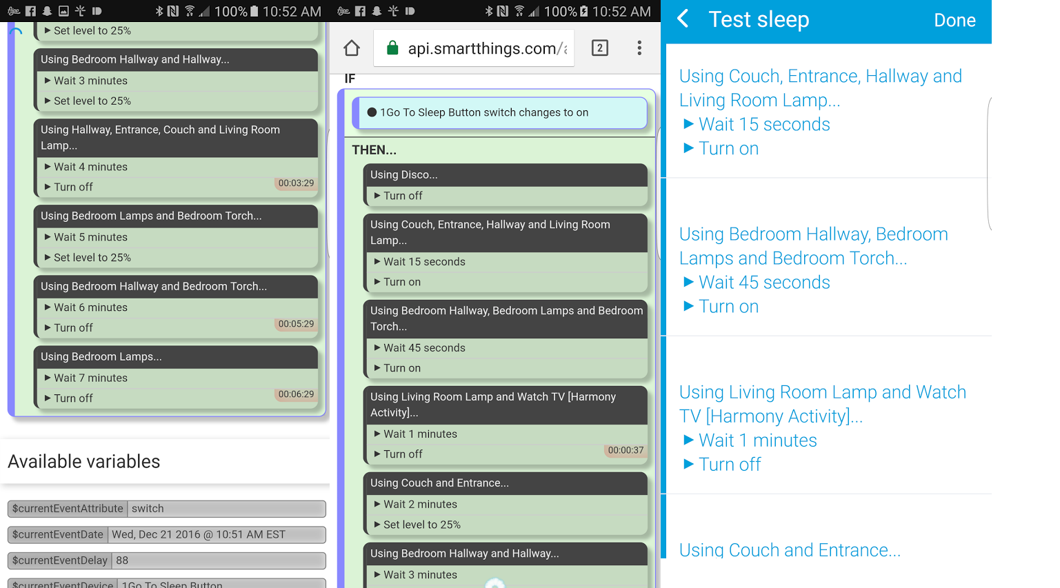

So, I am so confused here. for some reasons I can get lights to turn OFF , but if I want them to turn on they do not.
see the timer just times the offs, but none of the on’s or set levels… . I’m going insane, this is my first piston and its killing me. Ideas? please help?
Have you tried this using just one or two lights first? Something simple just to see if it will work as expected?
