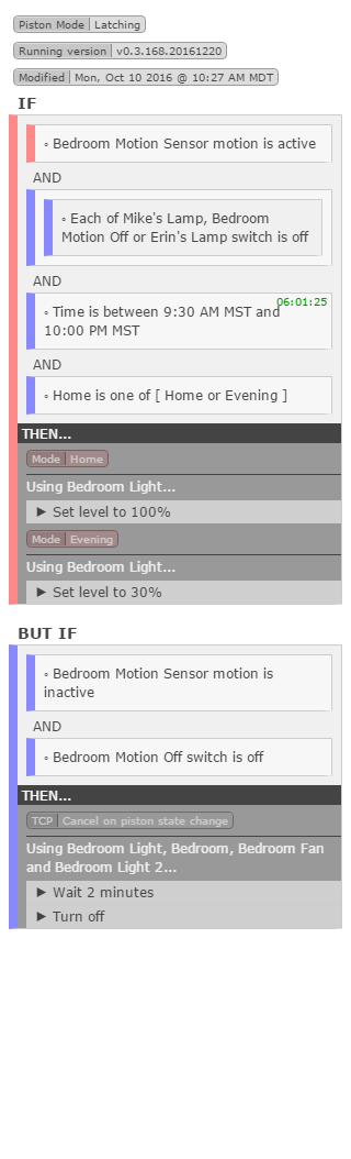

Put them all in one action. Actions start at the same time, so your waits are overlapping.
Yes, I have , and actualy, it worked… then I started adding more, just one at a time, and it stopped working for a few “THEN”'s.
I’m confused.
I am sorry for my ignorance in the matter, but how do you do one action, If I select all switches the house will just go all on and all off or dim, or something ,
or I am not understanding what an action is?
is that “Control location mode”? and then execure 1 piston at time for example?
thanks again
Here’s a piston with three actions, the first two are independent and have restrictions on when they act, both under the same rule set though. The third has a wait then action, notice in the same gray area. Lots of first time CoRE users will put the wait and action separate, but that doesn’t work. The actual action portion is entered under either the Then, Else, or If True/If False sections. Or variations there of under the different Piston types.
Well, then try to account for the time each action takes. The first action in the list does not delay the second, so if you want them to “follow” each other, keep a running counter in mind and add that wait to each start of each action.

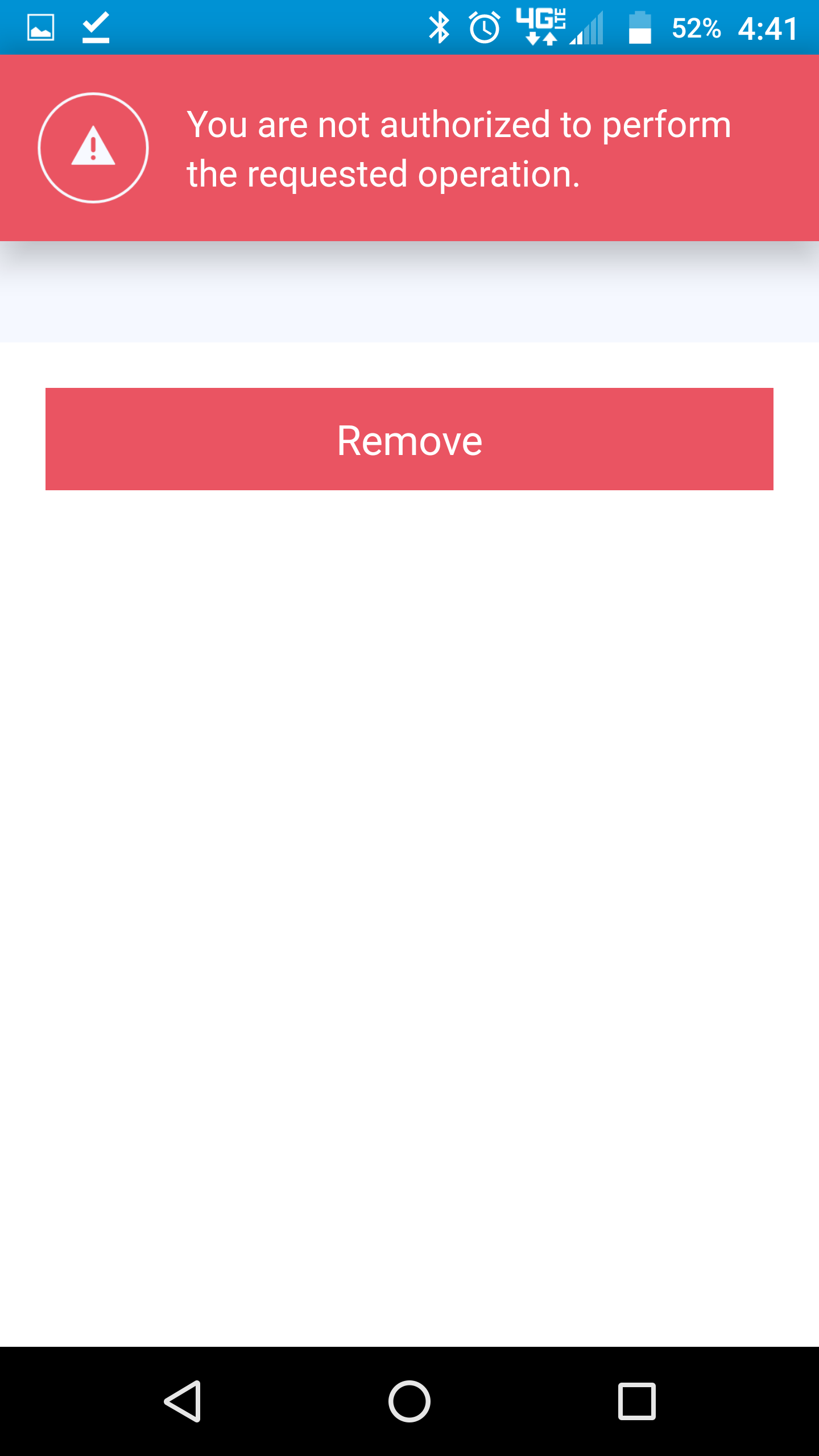

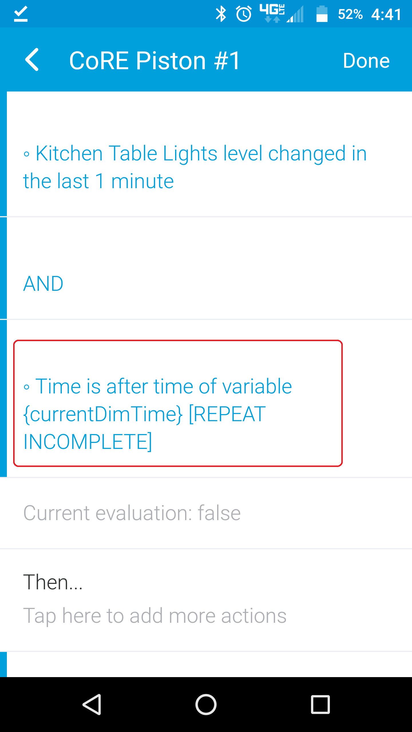

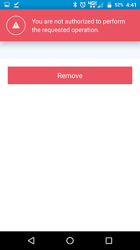

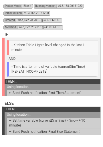

Hello all. I’m running into an error message with a piston involving a comparision of a time variable with the current date time. To simplify the issue, I created a simple piston that can demonstrate the error. I’m running the latest 12/20 build of CoRE. When the problem occurs, the only thing I can do to correct it is to delete and recreate the piston from scratch.
  1. My piston:
  2. Screenshot of where I am trying to click to modify the date comparison when the error occurs:
  3. Screenshot of error message
I have tried just about everything I can think of to make this work including clearing app data, cache, reinstalling smart things app, recreating piston in another way, generating new Client Secret, Client ID without success. Any help would be greatly apprerceated.

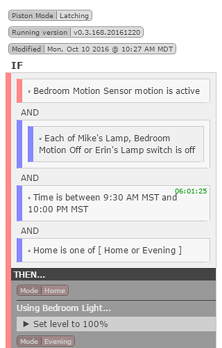

Frequent need to rebuild CoRE pistons - anyone else? I’ve had to rebuild 2-3 in the past week alone. These are typically scheduled things that aren’t firing when they’re supposed to (sunset/sunrise sorts of things).
I can go in and rebuild and they’ll fire immediately. Once I turned on another set of lights and that woke them up.
Any ideas? Sure, I can rebuild them every other day, but that kinda defeats the purpose of automation.
I also have to do this. I am not sure why. It seems like every week I have 3-4 pistons that stop working that need rebuilt.
