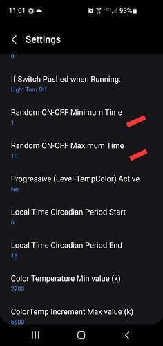

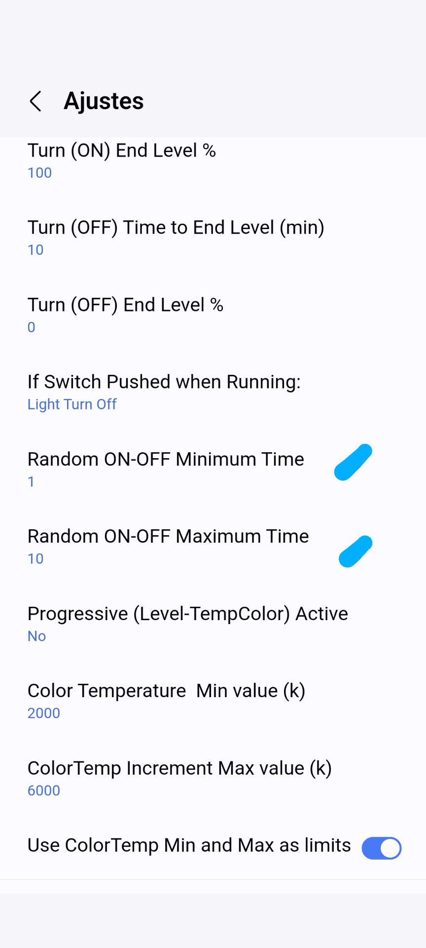

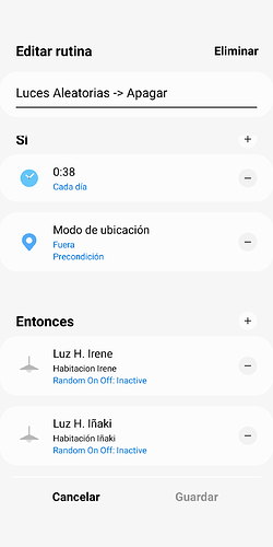

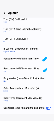

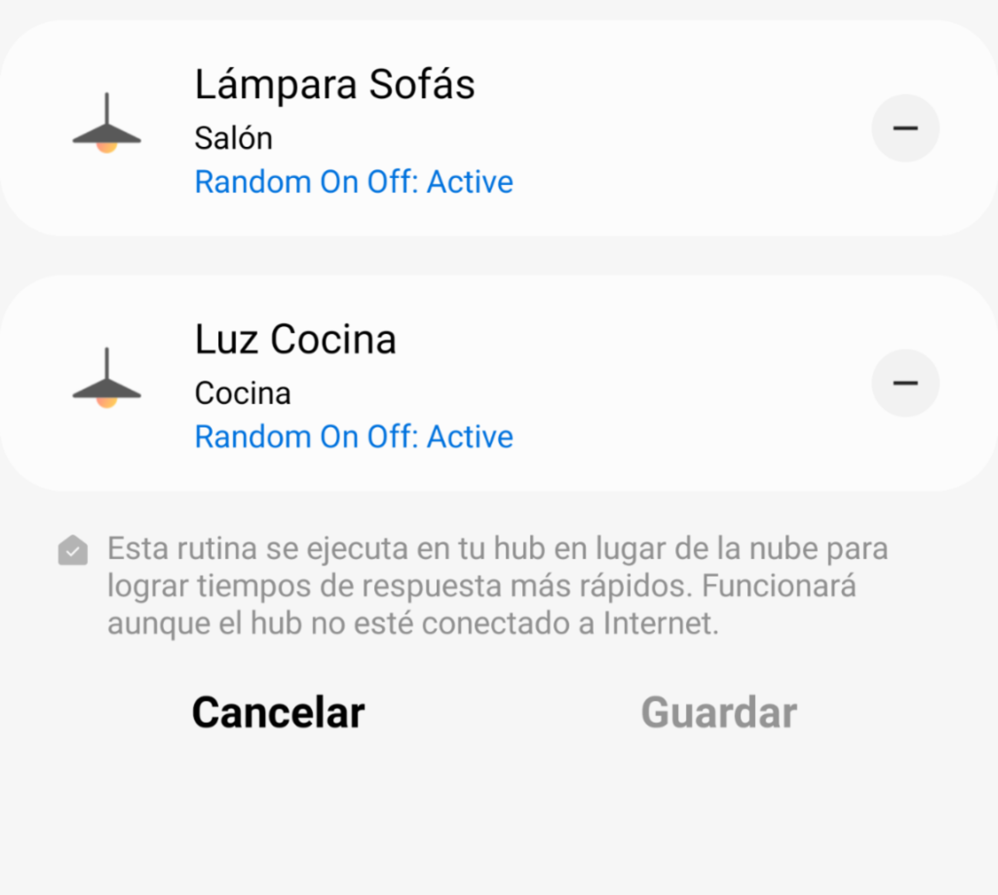

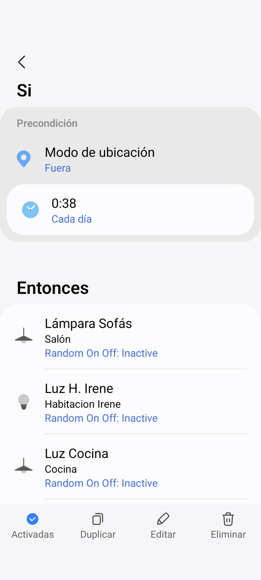

@Mariano_Colmenarejo Can i use this random function in a rutine how turns of a group of lights at a set time every day. For example at 22:00 so that the lights turns of at a random time between for example 22:00-22:15 ? May you also explain how i can use the random function from your drivers
Hi @Halvproffset,
It can be done

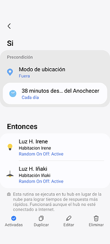

For each bulb you have to set the minimum and maximum time between which each random on or off is calculated.
You can make a routine that at a certain time and others conditions, activates the Random On-Off function in several bulbs.

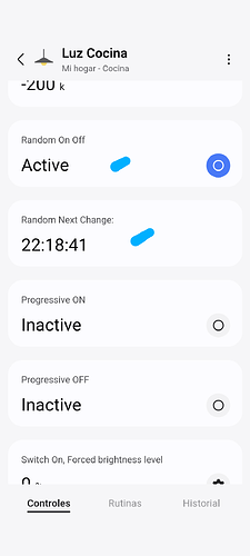

Each bulb calculates the random time of the next power on and will display the time at which the next state change will occur.
When turned on it calculates the random time to turn off and so on until the Random On-Off function is deactivated manually or with a routine.
When Random On-Off is desctivated then the bulb is also turns off.
I am confused by this. Does anyone have screenshots in English setting this up? I have a light I’d like to turn on at sunset but then turn it off randomly around 4 hours later. I’ve tried setting this up but it’s not working quite right. I probably haven’t created the correct switches or all the routines. Thanks.
@rcbjr2 The first step is to go into the light setting and define your Random on-off min and max durations in minutes.
You said you want it to turn off around 4 hours after sunset so you could set minimum to 240 (3.5 hours) and maximum to 340 (4.5 hours) or whatever you want and it will pick a random time between the defined min and max to turn off.

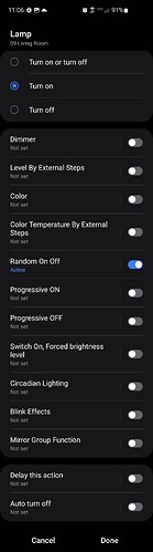

Next create a routine to start the Random action.
If at sunset everyday
Then turn light on and set random to active (this starts the count to the off action).
Last create another routine to turn off the Random action.
If light random is active and light is off
Then set light random to inactive (make sure to uncheck the top section because you’re not trying to turn the light on or off)
If you just want it to turn after it’s been on for 4 hours you can skip all this and just create 1 routine to turn the light on at sunset and use the auto off after 4 hours.

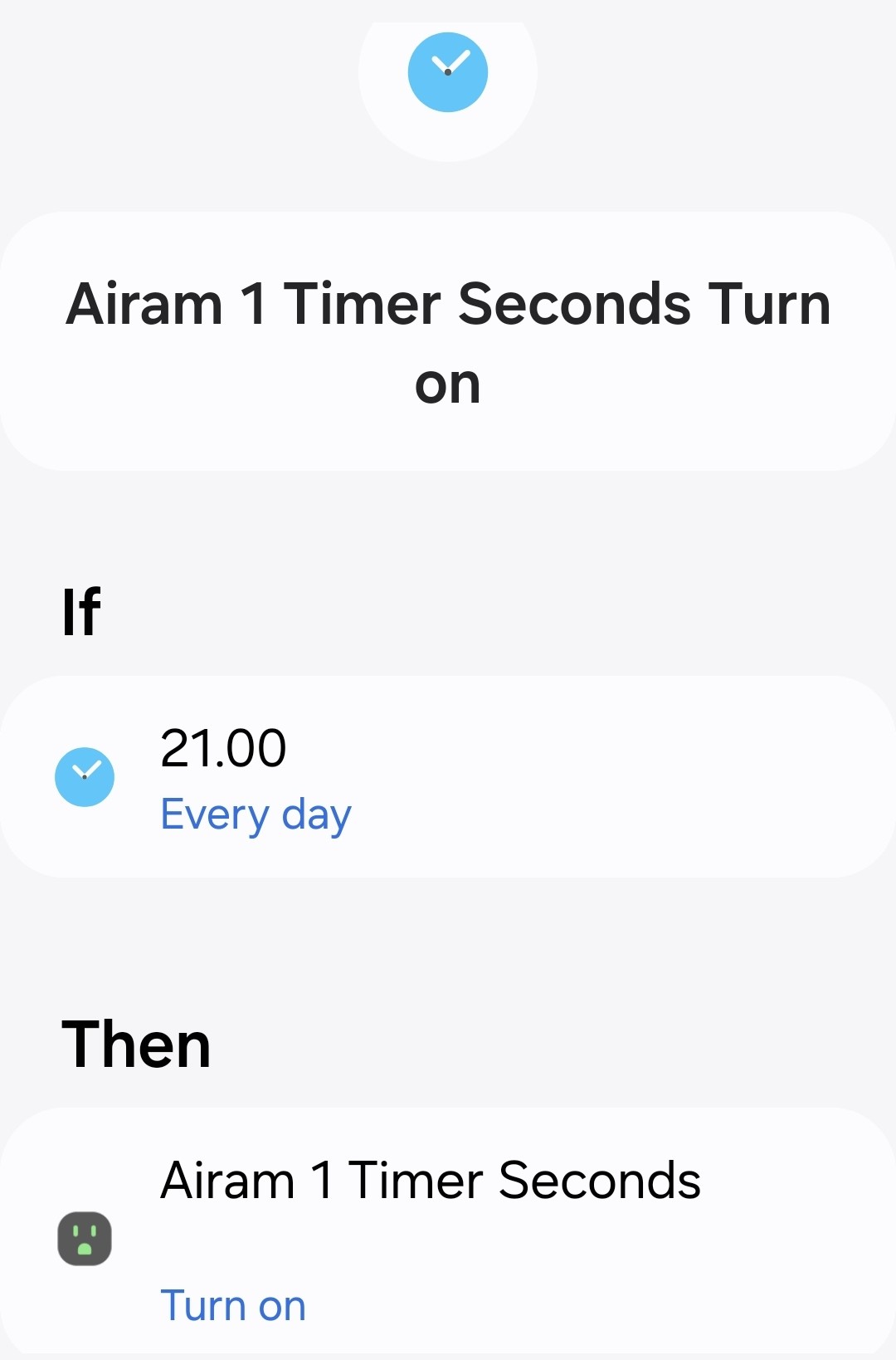

Yes you can use special virtual switch with timer function.
I have used this Timer of Seconds to implement random turning off light(s).
Example settings:
Timer Type Random Value
Random Maximum Timer Value 1800 sec
The light turns Off between 21.00 -21.30.
First routine starts Timer of Seconds (Random Maximum Timer Value 1800 sec)
When Timer of Seconds turns Off (after random time) then second routine turns Off the Light.
The precondition is optional. I use it as a reminder of when this routine is in use.
