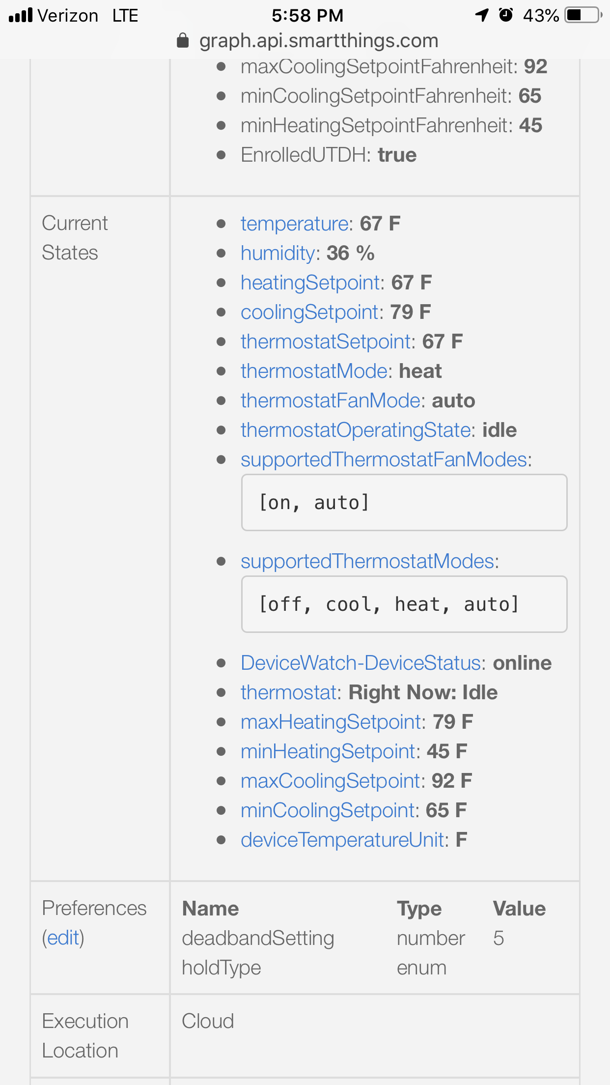

When you open the device and tap on mode a menu of options is supposed to show up. On off heat air.
I have 2 of these thermostats in 2 different homes and now nothing shows up, just blank.

@Brad_ST I see a similar issue with my ecobee. The current mode is blank, when I tap the tile I get a list of every option possible even though the possible modes are defined properly in graph. Classic displays correctly.
That may be an issue albeit a separate one.
The issue for the OP is that he doesn’t see any modes listed despite them displaying correctly in the IDE.
Maybe the same plugin shows all modes in iOS and zero modes in Android?
Indeed the device does appear differently in iOS vs Android.
I paired a CT100 in the office and the modes section is blank on Android and lists Off, Auto, Cool, Heat, and Emergency on iOS. I’ll file a bug report.
