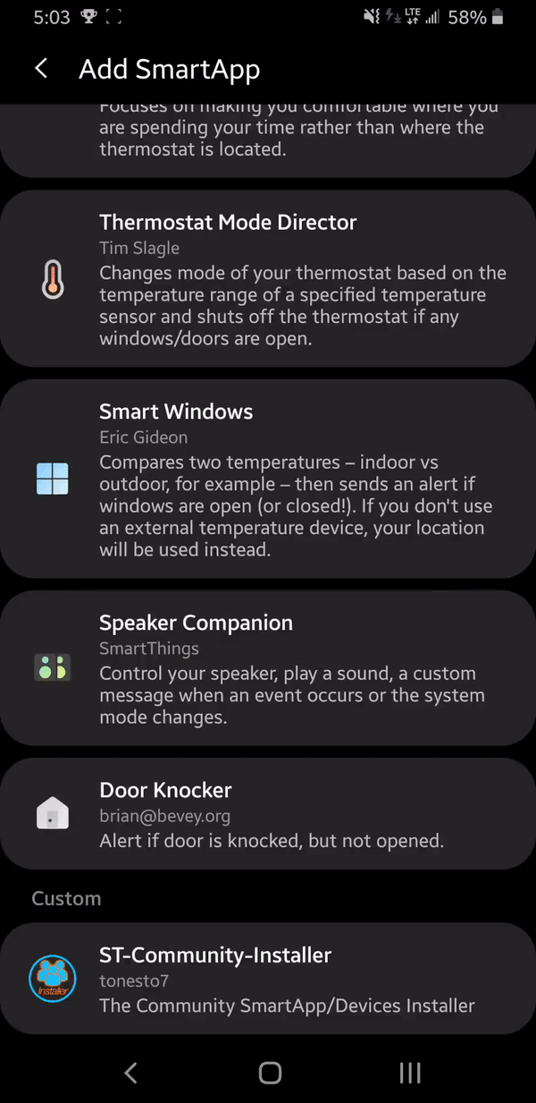

I just upgraded to latest Smartthings app from classic recently. Today I tried to add a few Smartapps, unfortunately none of them was success. It always shows “Process…” on screen and seems stuck there forever. I had to close Smartthings app to end the process.
My cell phone is Google Pixel 2 XL and all apps are upgraded to latest. Anyone has any clues? Thank you.

Good call @jkp - had this exact issue yesterday. Looking at pihole logs I needed to whitelist: usage.trackjs.com to get my custom SmartApp working again (required restarting the app also)
Even after disabling ALL ad blockers, restarting my phone,etc. I keep getting the “We’re having trouble connecting. Check your network connection and try again”. I finally got the Community Installer to show up, I click that, it shows the “welcome” screen for like 5 seconds and then throws that error.
I am stumped. The majority facing the issue have some type of pihole on their home network. The remaining users have some type of blocking software such as adguard or other malware blocking. It doesn’t appear you have any, so I am stumped.
