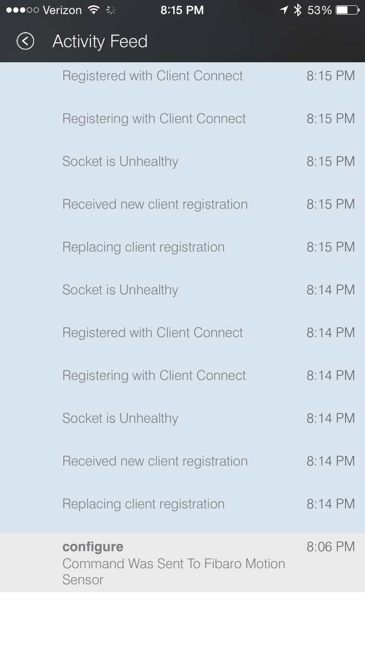

I cannot get the third one paired any more. Same results as others are complaining… :frowning:
Did you reboot your hub?, I guess that exorcism I paid the shaman to do on my network was worth the money…
Yeap…doing it again… It gets stuck at configuring in the logs
I just wonder what this java warning means, I am getting it when I pair the sensor.
Exception ‘java.lang.StringIndexOutOfBoundsException: String index out of range: 3’ encountered parsing ‘cmd: upda, payload: ted’
No clue…:frowning: 29.5 characs

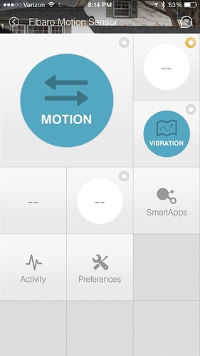

Giving up for the night. Missus is start raving mad… The temp appeared from somewhere at 80 some degrees of it’s own after a while… May be the lux will appear if there is 200 lux change. Will leave this outdoors to check tmrw morning. Leave it outside tonite to see if the temp falls.
Where is @wackware? We desperately need you, buddy! Here is where I stand! 2 sensors which i paired a week back working perfect in all respect. New one that I paired today only detects motion, vibration some times, temp stuck at 85 (sitting outside at 30 some degrees), lux and battery blank. And two remain unopened if I decide to return. :frowning:
Something is definitely wrong with configure.
Couldn’t resist it… I have three round sexy paperweights. :frowning: oh @wackware hear our call, friend! Help us help us we beg of you ! :wink:
It is not an issue and not causing anything.
OK folks, I think I have narrowed it down to hub firmware version. I found that with the new hub firmware version, it is difficult to consistently pair the motion sensor.
With the older hub firmware version (000.011.00709), I can consistently pair the device with all capabilities enabled.
