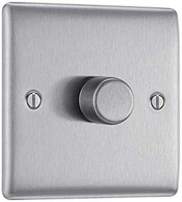

I’m having some work done and decided to change all my light switches to BG Nexus switches like this:
The problem I have is the new switches don’t seem to work with the Fibaro Dimmer 2. The smart functionality works fine, I can turn on/off and dim with SmartThings but the physical switch does nothing.
I’ve tested the switch on its own to confirm it actually works and it’s fine.
Is there anything I can do or will I need to change the switches?
