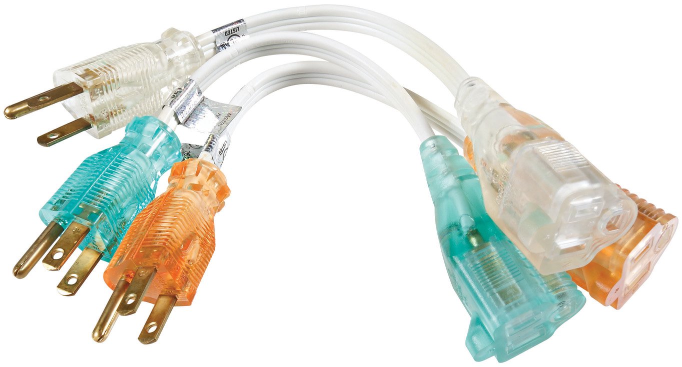

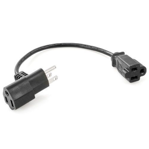

I think they all control the bottom outlets. The easiest thing will be to use a small plug extender like one of these. I personally like to pass through one. I use a white version in my bathroom.
http://ecx.images-amazon.com/images/I/61NYX5kVWgL.jpg
http://ecx.images-amazon.com/images/I/31fKCjh6N7L.jpg
