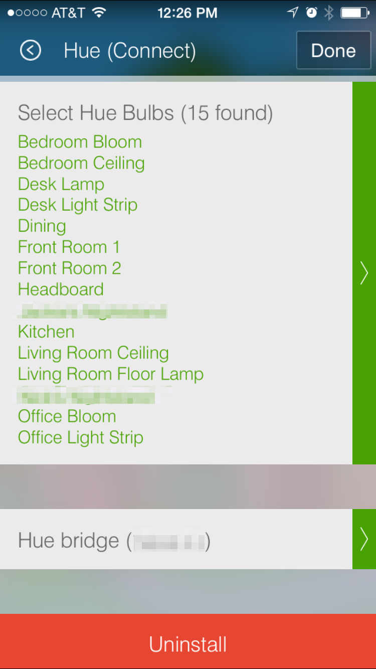

Tap in to the Hue (Connect) where it says “Bulb Discovery Started” and go to the bottom where it shows your “Bridge (IP Address).” If possible, compare that IP address to what your routers control panel says is the address of the Hue Bridge. Validate that they are the same. If not then tap into it in SmartThings and have it discover the new IP.

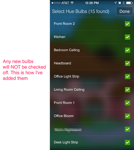

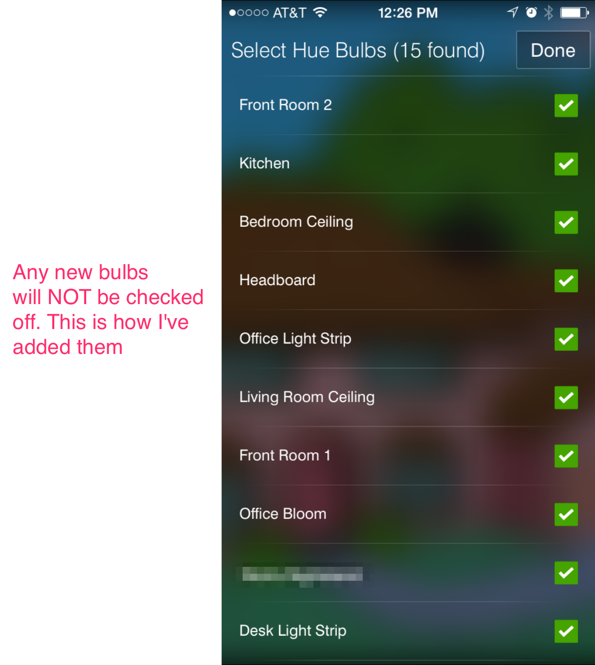

Here are my screenshots, this is the only way I’ve successfully added new bulbs without starting fresh…
I took a similar approach to restoring connectivity of my hue bulbs that I lost the ability to control via smartthing but could still control via the hue app… I noticed my hue Things said Hue Bridge was on a different IP than the one listed when I clicked on the Hue Connect gear/settings. My router uses DHCP and I think all the devices being rebooted (such as printer, hue bridge, smatthings hub, sonos, etc.) confused smartthings.
I ended up changing my router settings such that the MAC address of the hue bridge, smartthings hub and sonos bridge always map to the same IP address. Once I rebooted it took 20 minutes for everything to sort out and all of my hue bulbs worked again, without having to delete all the smartapps and devices. I had lost hue bulbs before and reinstalling took a lot of time and effort.
