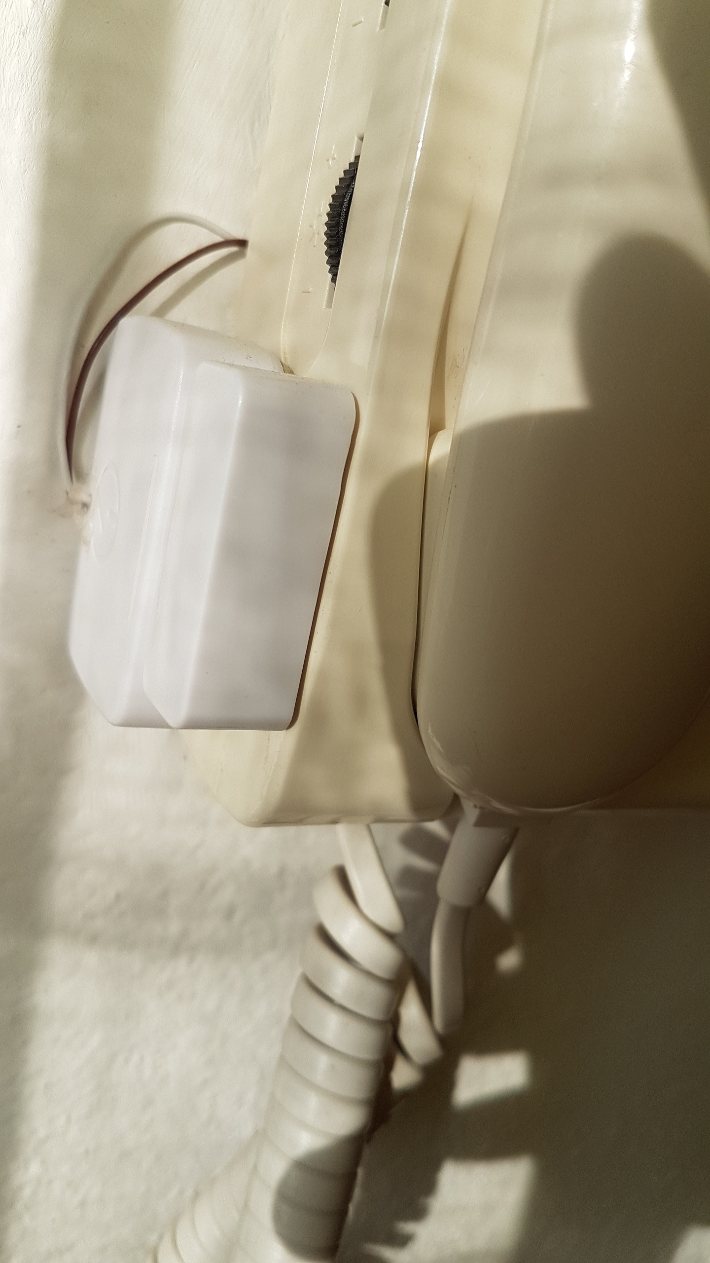

Check the battery, I’ll Bet it’s still good! I have had the same thing happen to me. I wonder if there is a connection issue. I have been thinking about soldering in a Battery Holder Box Case Buckle for 2 AA 2A 3V (3 Volt) ON/OFF Switcher. http://www.ebay.com/itm/Lot-20-Battery-Holder-Box-Case-Buckle-for-2-AA-2A-3V-3-Volt-ON-OFF-Switcher-/282054721859?hash=item41abc58143:g:9ScAAOSwNSxVPulL
You can do that, add that battery pack, I did it for a while it was fine, but then I wanted to change to constant power and forget about it so bought a buck converter, I set it at 2.9 volts it’s been fine.
